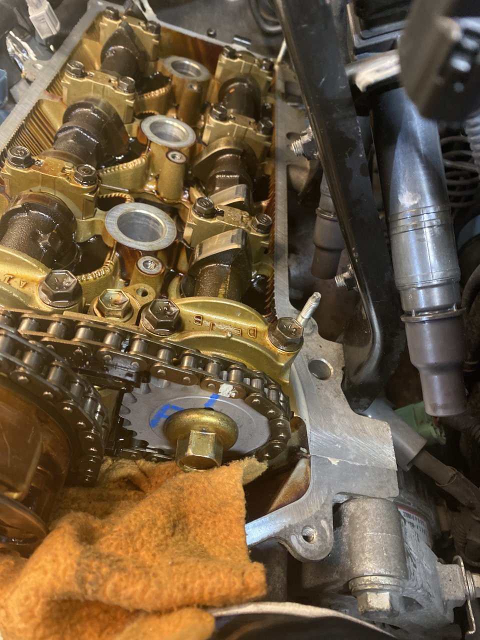

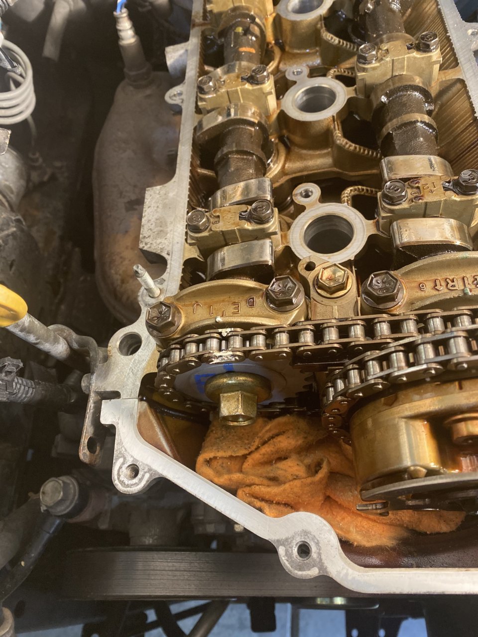

    Never mind, I didn’t say your motor wasn’t timed right. Glad to see you got it back together and it’s working!
    @mightytacoman but, he did have a paint marker haha. I mean you can use whiteout! Or your chicks nail polish (or your own o_O). What I was getting at is that this fixation on the orange links appears to create more confusion (than just following the FSM/ URD instructions), just going by the amount of questions you get on those. Maybe just more disclaimers are in order : if you turn your motor into a boat anchor because you fail to understand what you’re doing, you’ve done so at your own risk haha! I mean, if you’re opening up the motor, at least check if it’s in time. Cuz if not, you’ll gain more from fixing that... Anyway, it’s your thread so I’ll shut it now. Carry on!

    No worries man, I appreciate your input and everyone else's.

    Really no issues with the method, it works perfectly fine(obviously) and is probably better for a newb (or at least people that don't take their engines apart every weekend..)
    If you want to line up the orange/yellow links you just need to realize there are 4 on the rear chain and one set is for each exhaust cam and one set is for each intake cam. If I'd had realized that and that it was going to take sooo many turns of the crank to get them there I wouldn't have been concerned/surprised. Maybe I just needed to read it better? I read everything you wrote and not necessarily every comment from everyone else.
    The only other thing I noticed during the install was after I took the chain off the cam spun because of where a lobe was on a valve. If I didn't still have the wrench on the Cam it would have been hard to know which way it spun to put it back (if that even matters as long as the pin lines up).

    Passenger side jumps correct?

    Yea the passenger side took a little messing with to get the pin to line up with the gear because it was jumpy, the driver side moved smoothly.
