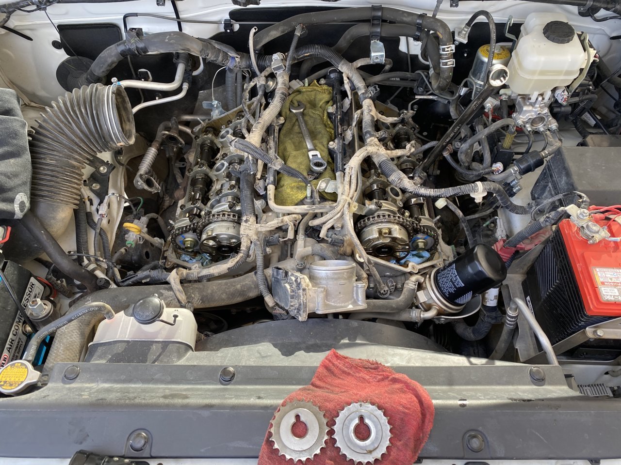

    Second truck of the day!

    Damn you’re cranking these out! Thanks again for the price suggestion. If anyone in western WA wants these done, I’d be happy to help

    Did mine today. Not bad at all. If anyone in Noco needs help, I'd be more than glad to teach.

    Anyone else have a nightmare of a time getting the factory gears off? I started with breaking my crowsfoot, which turned into taking the whole cam out, using a bench vice, MAP gas, and 20-30 seconds of air impact to release the bolt... all on a motor with 18k miles.

    This is the exact reason why i left the install to someone @greenEFSI with vast experience on this. And i confirm that even he had to hulk out when trying to crank that bolt loose. That thing is on tighter than a mofo and I was worried that my set was going to be the first failed job for Gio....until i heard the CRACK that signaled the bolt was freed. He had a fancy snap on wrench adapter extension that provided the required leverage.

    A 6 point wrench with a 4ft cheater bar is my goto. One of the reasons I don't torque mine down, just really snug them. They seem to work their way tighter as the engine runs

    That's a bummer to deal with on such a low mile motor.
    We were worried for a second there! :benchpress:
