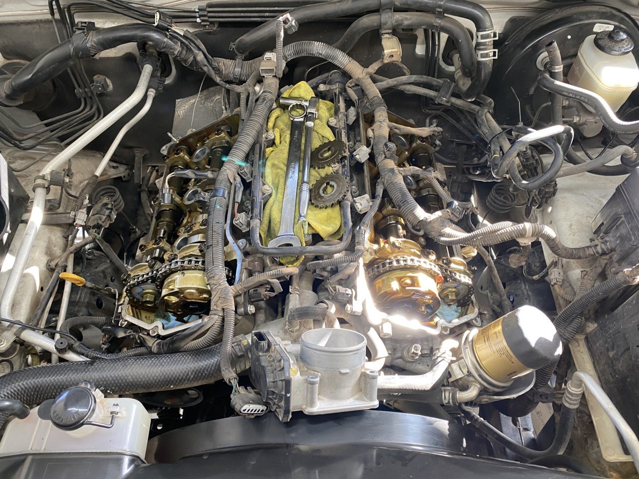

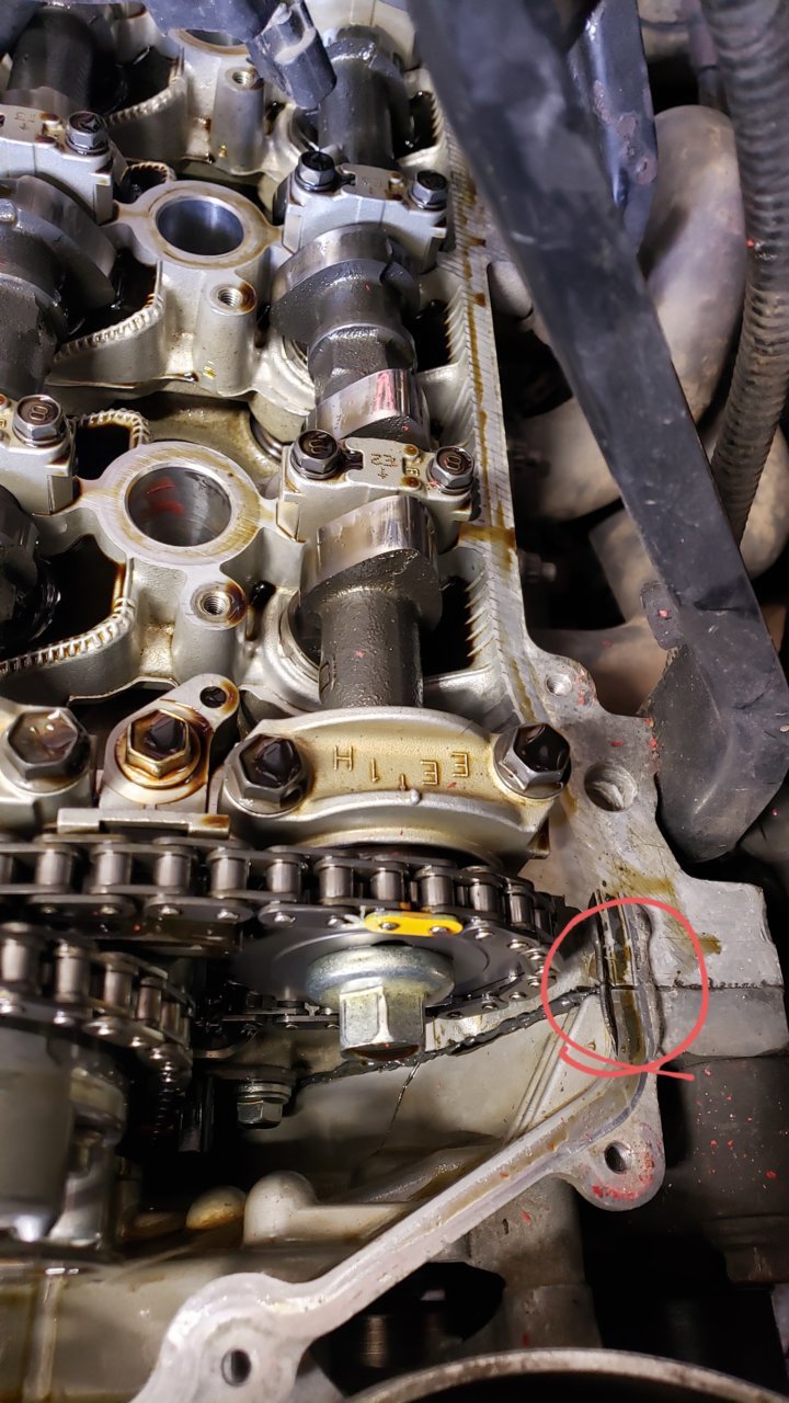

    hey guys. lot of great info here. Received my cam gears and planning to install them this week.
    seems pretty simple to do, but the only this i dont 100% understand is where do you put the gasket meaker thing. its not on the valve cover at all? just on the timing chain cover and the head? in fron of the cam gears pretty much?
  19. Apr 11, 2021 at 11:58 AM
    #1419
    mightytacoman
    mightytacoman [OP] Mighty-known Member
    Apr 3, 2013
    #101270
    2,412
    Kel
    4.5L 1grfe
    Brian Crower stroker kit, Carrillo pistons moly/ceramic coated, BC sportsman rods, arp s2000 head bolts, Darton M.I.D sleeves, Kelford race cams, Magnusson supercharger, hp tuner tuned, 650cc flow matched fuel injectors, CSF radiator, Walbro 255 fuel pump. pulleyboys quick change pulley with 2.3", fpr mod, NST crank, water and alternator pullies, 160° mishimoto thermostat. Puma On-board air, Radflo CDC ext coilovers with 14" 700# springs, extended length rear Radflo shocks with CDC, Dakar leak pack, Brute Force Fab front bumper galvanized and powder coated, DTRL mod, yellow fogs, fog anytime mod, relocated rear differential breather, synthetic fluids, custom airbox, tundra sized intake. 76mm throttle body, secondary air filter removed, Airflow snorkel, 4x innovation sliders powder coated, URD equal length headers, DT y-pipe, Aero-Turbine 2525xl exhaust dumped over axle, seat belt chime disabled, Warn 8000i winch, 1- 20" slim light bar in grill, 42" curved roof light both with custom brackets. Mesh grill, Brute Force Fab rear bumper with extra reverse lights, u bolt flip kit, SS extended brake lines, hockey puck bump stop extension, AT shackle flip kit, Light Racing UCA's, 4crawler 1.5" bodylift. custom built front and mid skid plates, re-geared to 4.56s, windows tinted 25%, Sony stereo, 8" skar sub-woofer, 1000 watt mono amp, retrofit headlights with legal demon eye, Kryptek Marathon seat covers. North Star agm 27f battery, Helo 791 rims, 315/75/r16 Mt/r ARB front air locker
    You don't have to take the timing chain cover off (its a little square ~3x3" cover on the front passenger side for those wondering)
    The gasket maker goes in between the valve covers and where the heads/front cover meet. 4 locations total (2 per engine bank)
    With the valve covers off- you can see where the 3 parts mate. There is a chance of a leak here so it is recommended to add ~1" strip of gasket maker here to prevent that.

    got it. thank you. everything else seems straight forward. probably will start on it tommo.
