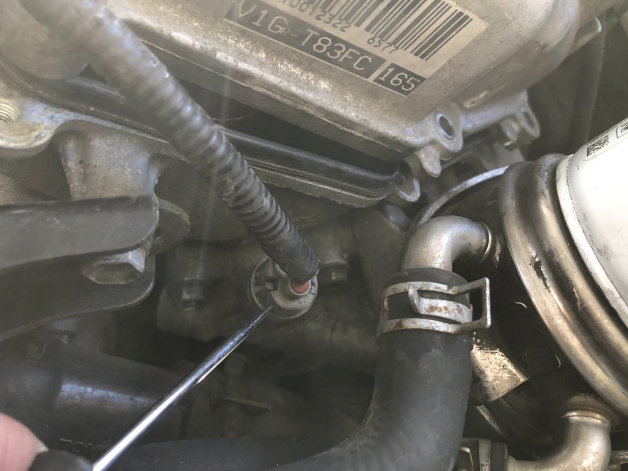

    found out the hard way after breaking one,
    that answer = spray with lubricant such as silicone, then gently wiggle a small flathead screwdriver on each side in the tab (pocket screwdriver) while wiggling up with constant pull

    I found that a slotted door panel and plastic retainer tool works wonders on them.

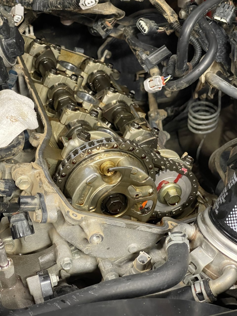

    So once the engine is at top dead center and I install the new cams, it will look like this? The “dimple” on the bottom of the cam gear?

    This looks correct.

    Sweet. Then I’m golden. Installed it today. I have a 2015 so I have the air pump on the passenger side….took me 4 hours from start to finish and about 30 min of that was struggling to line up the intake manifold bracket. Couldn’t get the lower 12mm bolt started by the headers. Turns out you can go in thru the wheel well.
    I will report later how it drives after putting on some miles
