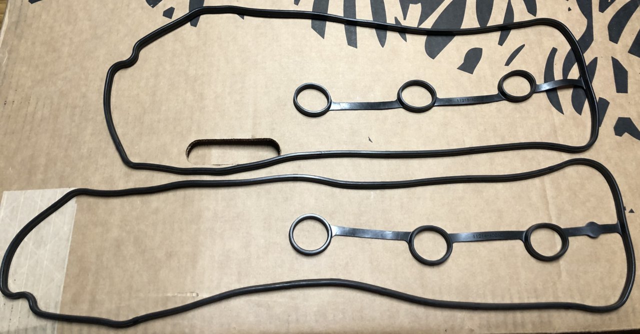

    Looks like I'll finally jump into this this weekend.
    @Turdyota3000 you got me thinking I need to double check my valve cover gaskets! I haven't looked at the ones I was sent since receiving them months ago, and even then I didn't really look at them. they were just sent in the box. No bag w/ part numbers. I'll look when I get home, but is there obvious differences I'll see comparing them to each other?...as in, as long as they don't look identical to each other I'll know once I go to install them.

    I've had a local dealer mess up valve cover gaskets twice now in random bags with no labels. The two are very different from each other, so if they look the same it will be a problem.

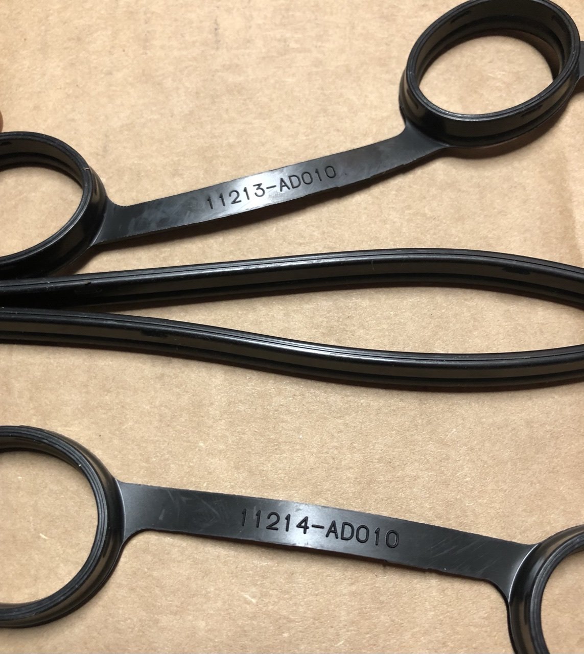

    They looked similar enough to me to give me an oh shit moment initially before fully laying them out lol. But part numbers are actually printed on them. Different overall lengths too. Here’s pictures for the thread anyway.

    ^ Which one goes to which? Which PT# is for our trucks?

    Both. One for each side.
    Part numbers are on first page.....Copied from that; Gasket part numbers:
    • Right (passenger) Valve cover gasket - 11213-AD010
    • Left (driver) Valve cover gasket - 11214-AD010
