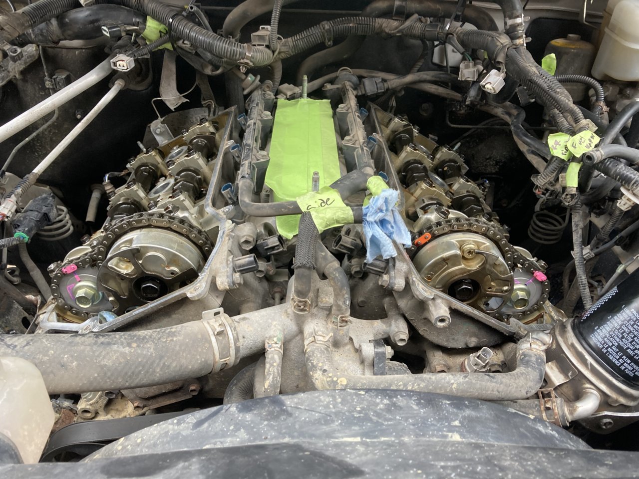

    Finally got this done today! Really wasn’t a hard job. Just time consuming pulling everything off to get to the gears like everyone has said. Was a full afternoon.
    The cam gear bolts weren’t nearly as bad to get off as I thought it was going to be. Don’t get me wrong they were tight but not that big of a deal. I decided to live dangerously and used the 17mm JTC Mercedes wrench on my 2 foot breaker bar to break the cam bolts loose. Had zero issues, it was plenty strong and felt more secure/less sketch than my box wrench with a pipe on it. Also used it at 90 degrees to re-torque them.
    One trick I found handy was instead of trying to undo the two clips on the back of the intake manifold I just removed the 10mm bolt holding the bracket and then unclipped them once the manifold was off.
    I’m gonna let the FPIG setup overnight since that’s where my valve cover leak was originally and test drive it in the morning. Hopefully I didn’t leave a paper towel in there hahaha (almost did but caught it putting the valve cover back on).
    I also forgot to install the new manifold gasket I bought because it started raining and I was rushing. Not sweating it though, I replaced the valve cover seals and that’s what was leaking on me.
