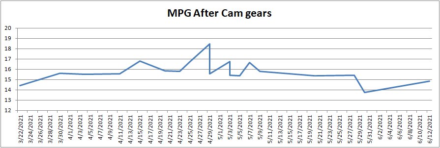

    I wonder if @Sandman614 or @gpdx have any updates for us since their initial impressions…

    Pretty much the same as I described before. More power/torque/top speed, butt dyno says no. Less draggy/engine braking, still yes. Offroad in 4Lo/lower gears doesn't seem to be changed, there is still enough engine braking to crawl down hills and enough/same power to climb hills. Higher MPGs, need more data but not looking all that impressive(some variation because I swap back and forth between 31" AT and 33" MT tires).
    Would I do it again, yes, but not because of all the claimed improvements. Remember this is on a bone stock 4.0L.

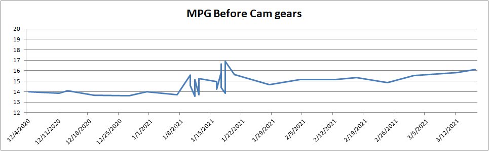

    My MPG when >70mph is around 12.5 BEFORE THESE GEARS with camper @ 5800 pounds above 70mph. I just did a 1600 mile road trip with mostly interstate above 70mph and the truck just burned through the gas.
    My more local trips on state highways and local roads, I usually get 15-16mpg PRE GEARS.
    I'll update soon (hopefully in the next month when I service the Supercharger and order parts).

    I read that twice and still don't know what your results are after the gears. All I've gathered is that before gears it was somewhere between 12.5 and 16 mpg and now it burns through gas?

    I don't he has installed the gears yet. These are his observations with his truck before install

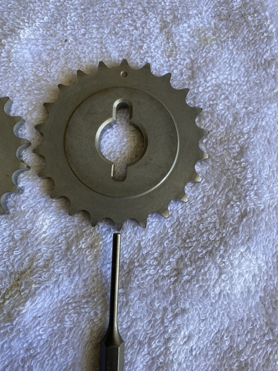

    @mightytacoman is my punch pointing at the correct tooth?
    that key way has a very small bevel to it

    That's the correct tooth. Pictured is the back side of the gear. When installing- that bevel aids with install and isn't on the front of the gear.

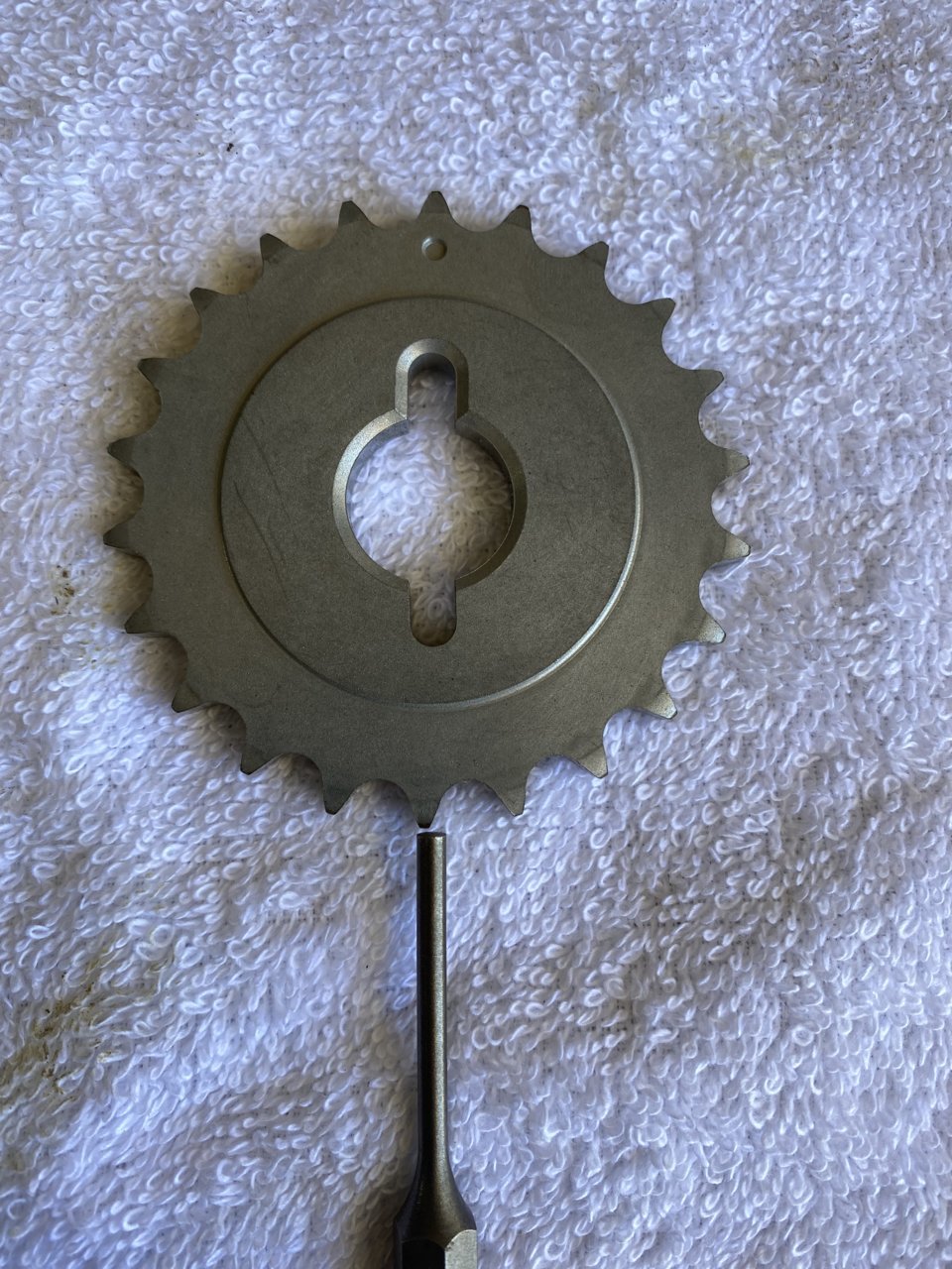

    Ok thanks. So now this is the correct side and tooth? No bevel

    correct tooth and side. mark it with some whiteout/ nailpolish, paint marker etc. and you'll be good to go
