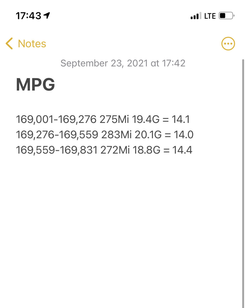

    I had the opposite, lower MPG, went from getting at least 15 consistently to 14. Even babying it I only got 14.5. And you’re right, feels like it lost a little bit climbing hills. Will be putting it in after I finish tracking this tank of gas.

    Yeah sounds about right, like stated MAYBE better mpg, but its hard to have consistent driving habits.

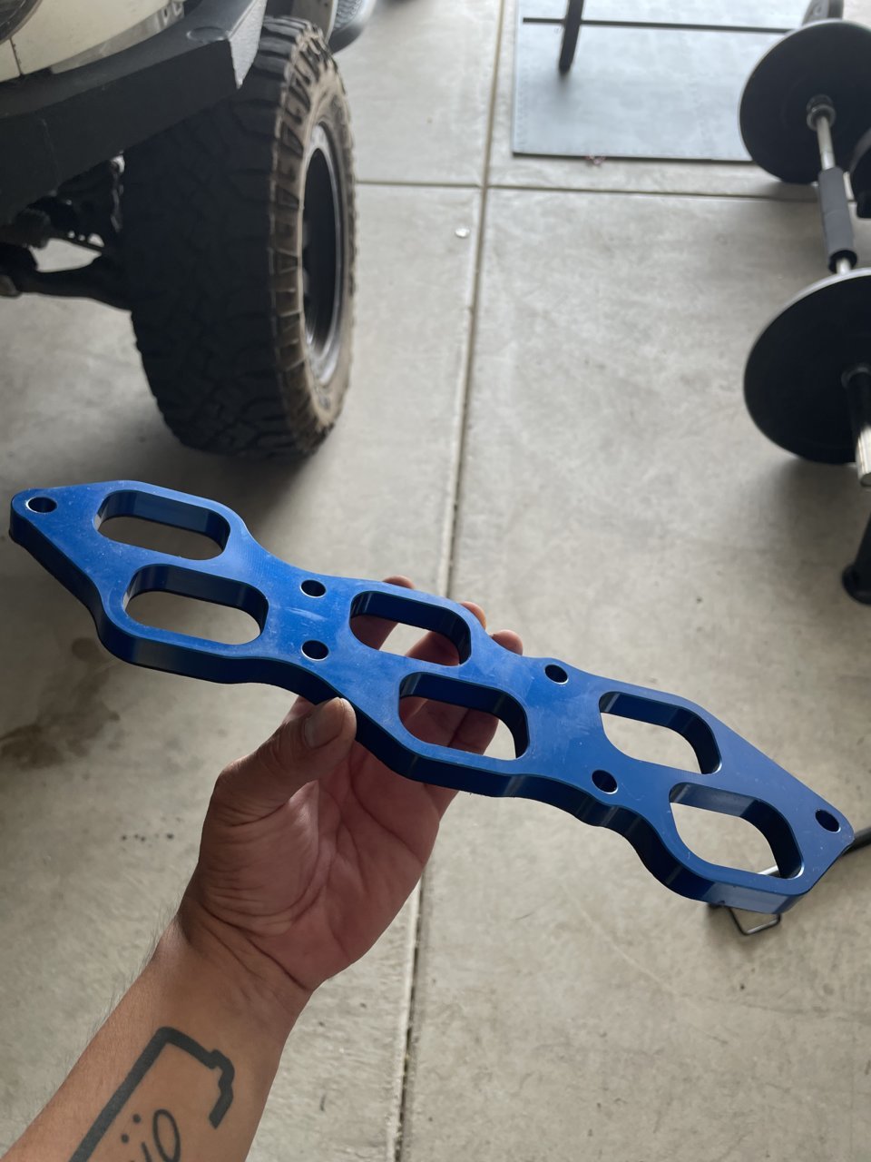

    Watch out if the 4 runner is anything like the tacoma, there is a wire harness loom that runs at the top of the firewall just below the cowl, i noticed that with the 110k miles i had on my truck with the spacer in the heater core lines rubbed on the wire harness loom and started to wear into the outer sheath. I will be sorting that when i do reinstall the IMS.
