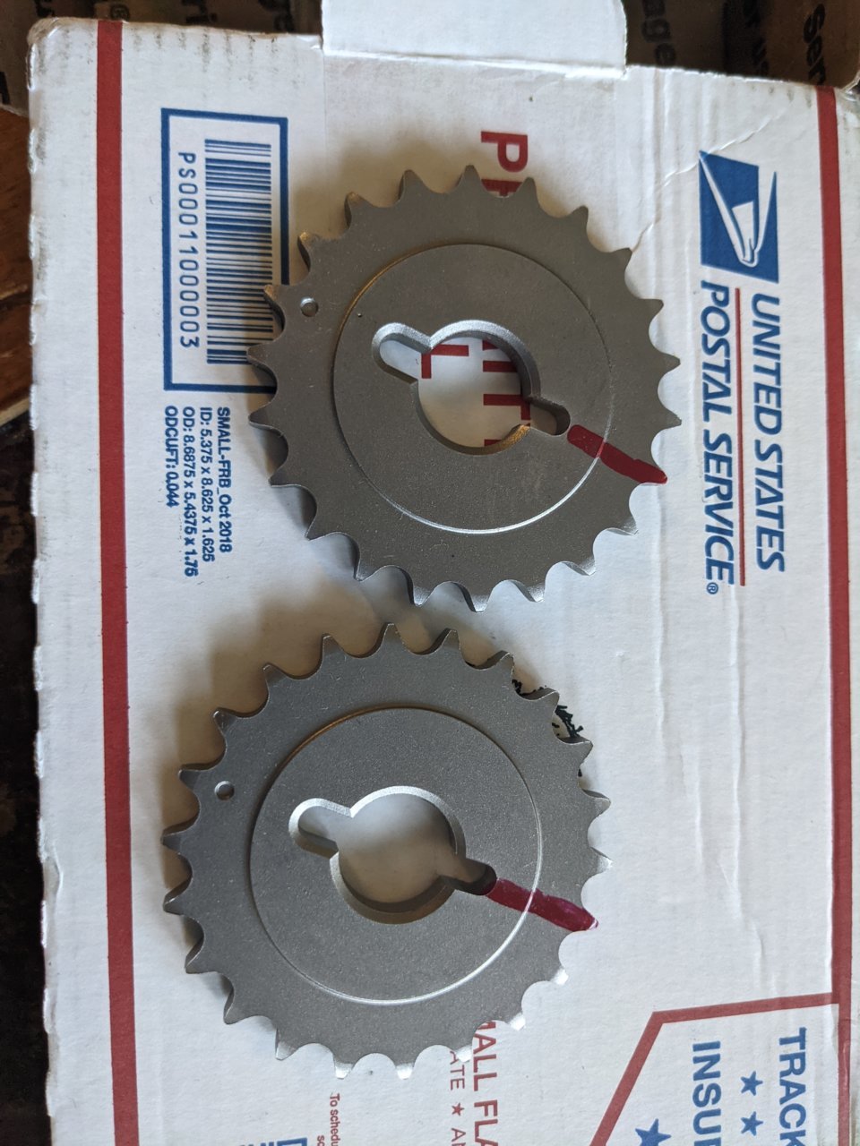

    Got my gears today. Originally planned to install them tonight but need to push it off until tomorrow. Really stoked to get them installed.

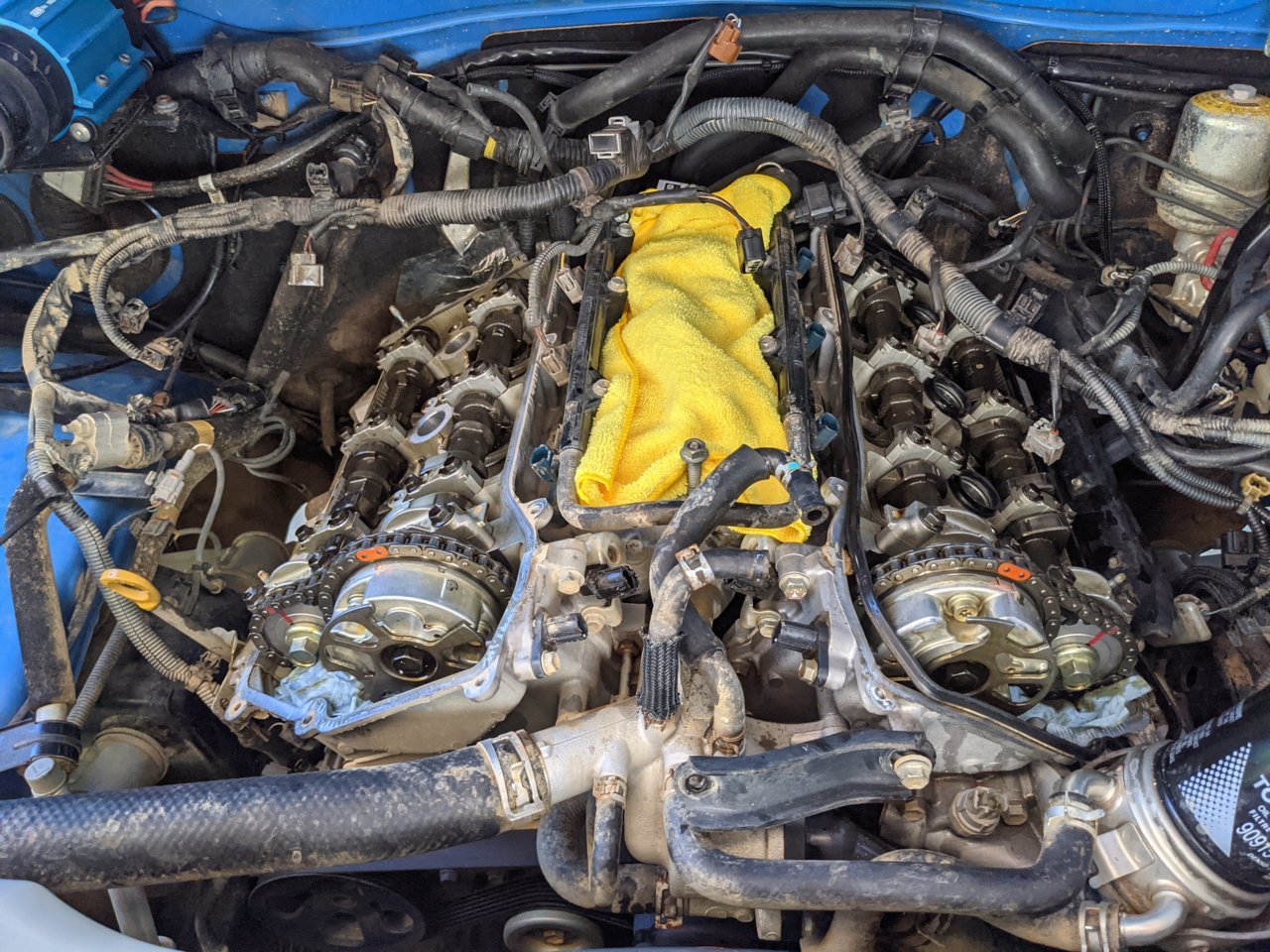

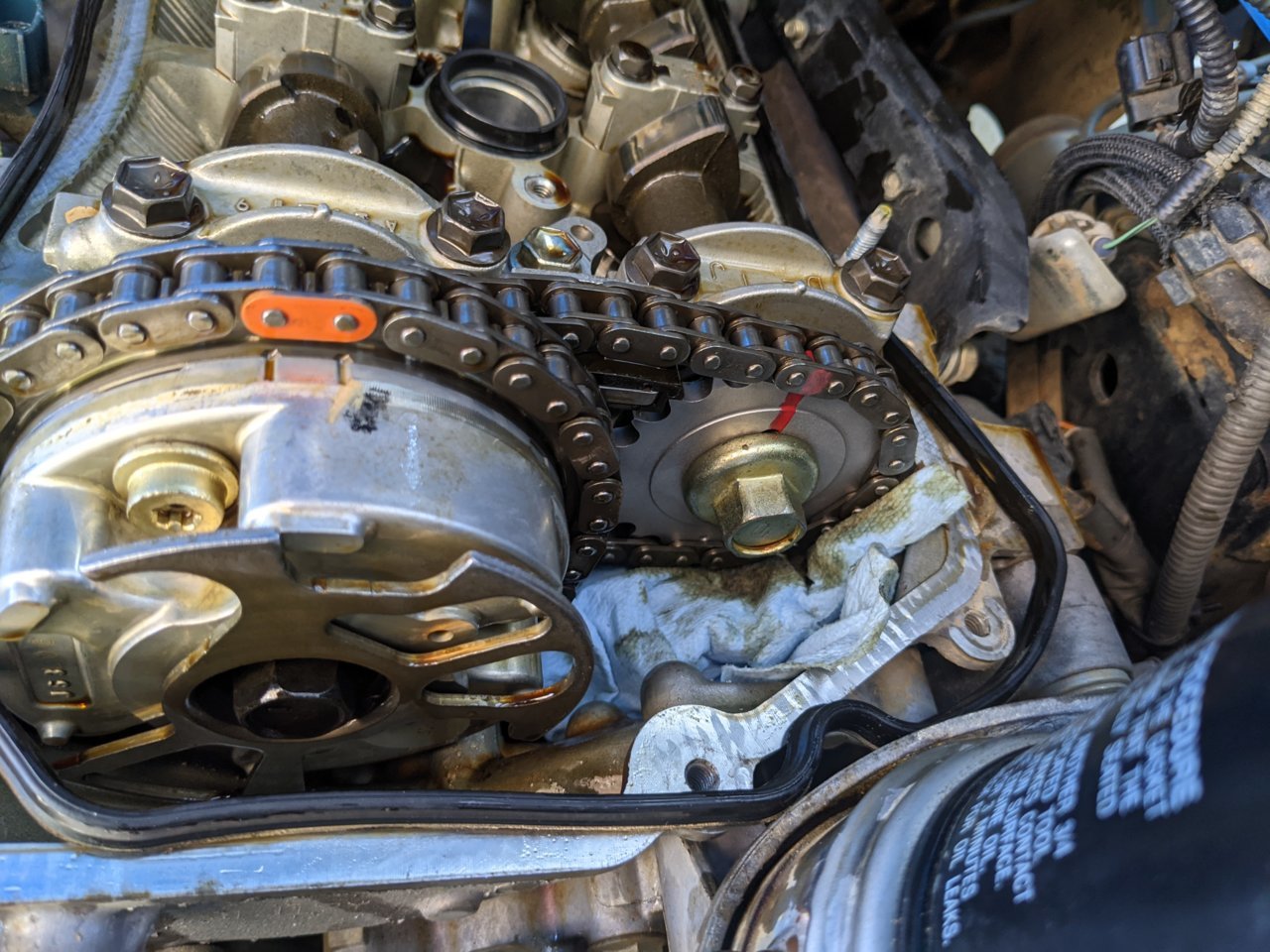

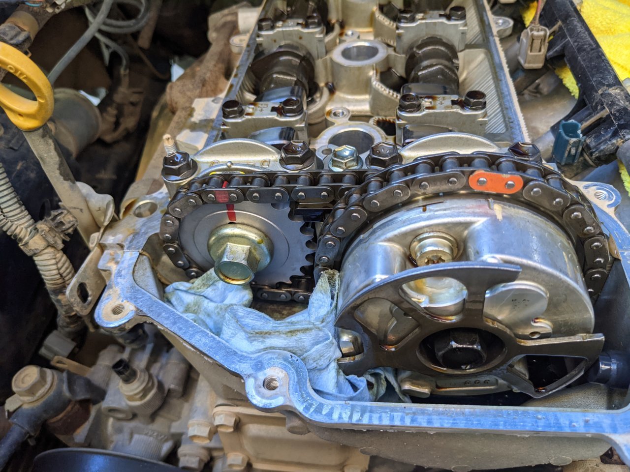

    Got them installed this afternoon on my FJ. Only took me 3.5 hours start to finish. Like others have said, those cam sprocket bolts are TIGHT! Managed to break a serpentine belt tool and had to resort to double wrenching it for more leverage which worked. One thing that made me laugh is that 3 out of 4 marked links lined up without even trying. Hard to tell yet if I picked up any power or not. I unhooked the battery to reset adaptations and only took a short drive. Should be able the give a better assessment over the next few days. PXL_20210928_184219782.jpg PXL_20210928_184222754.jpg PXL_20210928_184225352.jpg

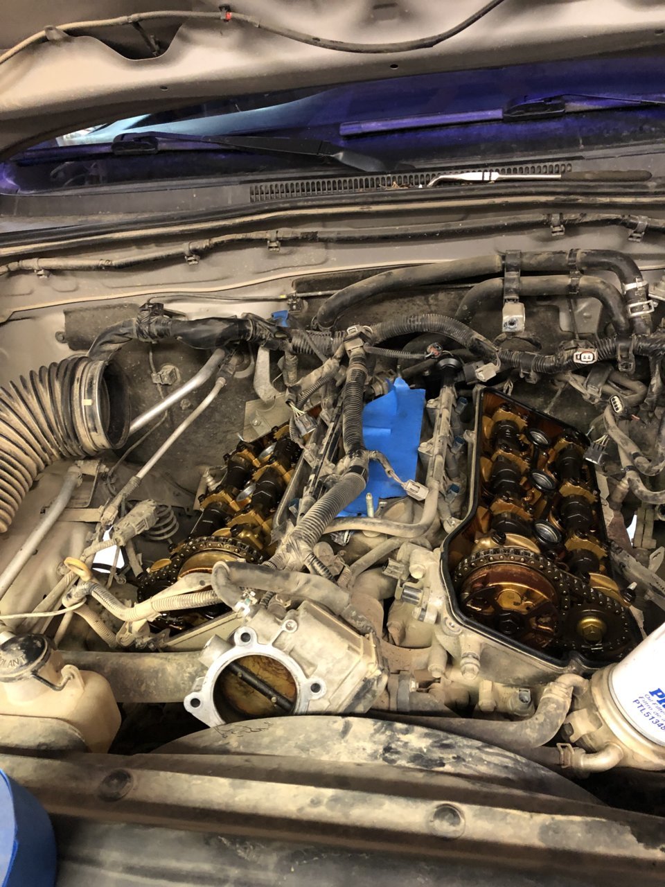

    Had mine installed yesterday by @greenEFSI and he did a great job. Thanks Gio!! Mine was a little more complicated with the supercharger in the way too, but he knocked it out in 5 hours flat. I immediately noticed the engine running smoother, and noticeably more pep in the lower gears. More zippy now, feels like it did before I added the 33's. Also noticed the shifting was a little smoother. For some reason my truck sometimes doesn’t want to downshift on the freeway when I think it should, so hoping the gears fixes this as well. So far happy with the mod, but time will tell how happy I am long term. looking forward to better gas milage, but with the SC, I'm doubting that will happen. Just too much fun!
