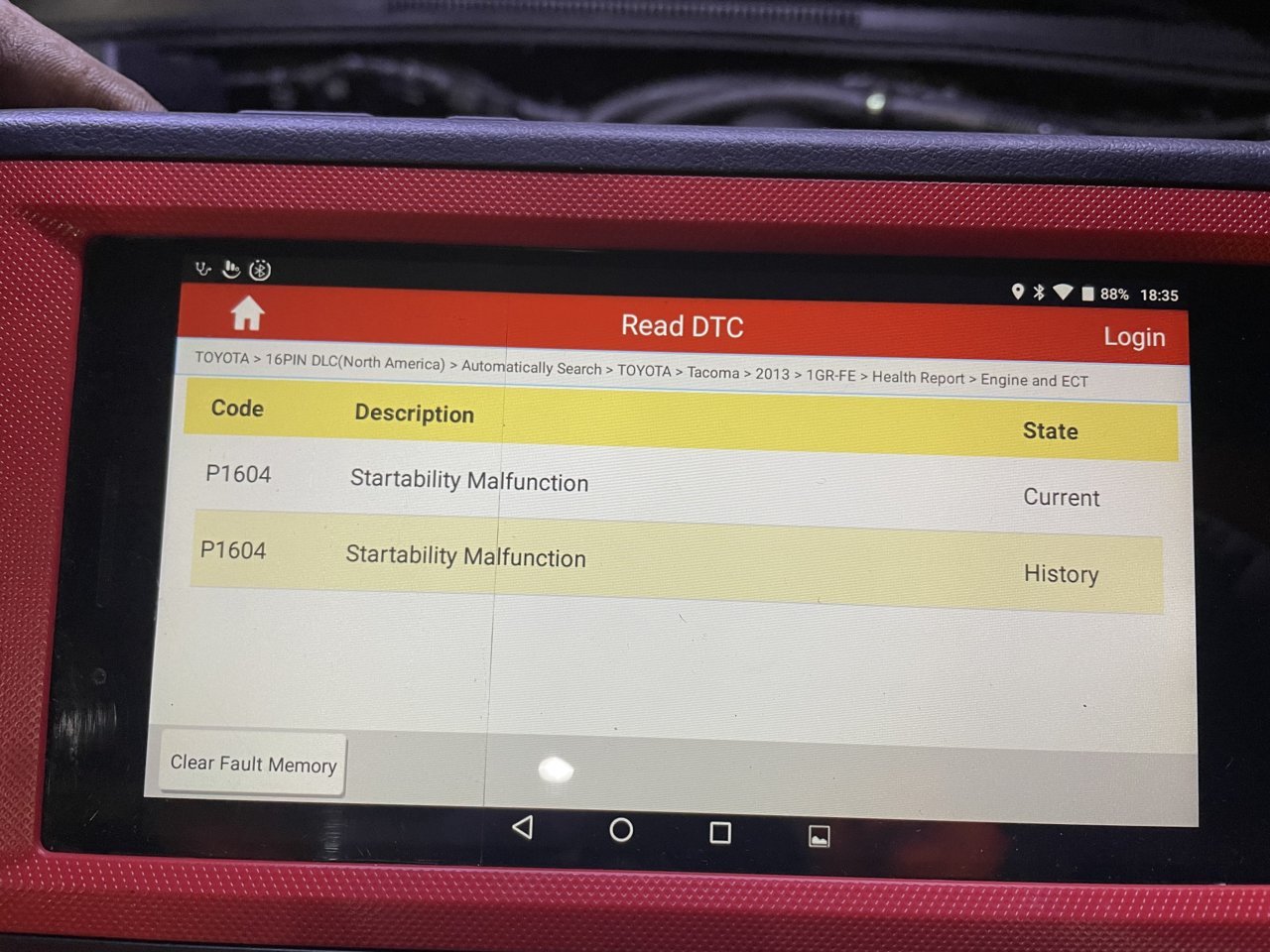

    Well, it took 6 days but started doing it again this morning. Time to take it to my buddy to reset the ECU and see if there are any codes popping up.

    This was the only code that came up. Everything else looked good, and he checked literally hundreds of things.

    Have you tried checking your grounds since you did the cam install? Maybe one got dirty or worked loose. Did you say it only happens at idle? What about high load heavy throttle input?

    I’m about to upgrade to a high amperage alternator, and upgrade the big 3. Then all of my groups should be handled. Only happens at idle under load. I’ve also been off-roading quite a bit, so I’m gonna try cleaning air filter and mass air flow sensor. Also gonna upgrade a bunch of clamps on lines to tighter clamps. My guy thought it may be an air leak causing the engine to get pissed off.

    So p1604 is basically- the engine takes/took longer to start then it likes. Most likely not related to these gears.
    If you have a small vacuum leak- that would cause a rough idle that you experience. If your charging system isn't keeping up due to older battery, bad connections, etc. That could pop this code.
    Doing the big 3, new alternator and a fresh battery might just be the ticket.
    Edit- dirty maf sensor was my initial thought when you posted about this problem originally. And since you've been offroading as of late- it's worth cleaning to rule out.

    Have not experienced the problem since the ECU reset. Fingers crossed that fixed it.

    Nice looking truck, If you had cleaned the sensor- I was gonna say it was probably that. But if the ecm reset is still doing the trick- we might have found your problem.
