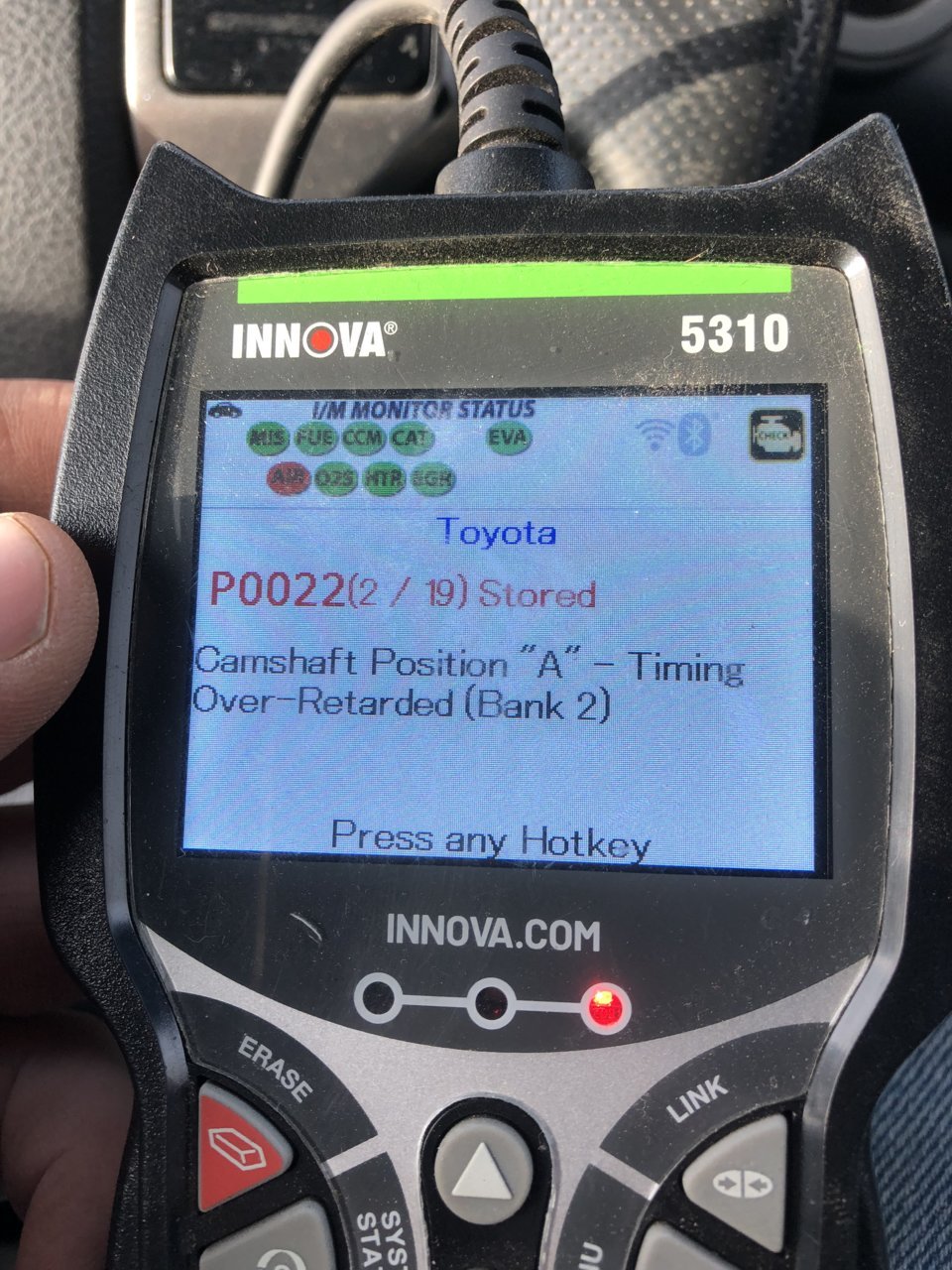

    So you installed yours back in August and now you're seeing the P0022?
    Are you supercharged? Do you have a tune? What other mods do you have?

    N/A, Justin tuned it,18mm spacer below the surge tank and URD headers. I think I installed them around late June 2020. Also ordered the Red Bullet VVT valves from the group buy. My EVAP canister always throws a code but today is a slow day at work and I checked the codes for shits and giggles. So not sure how long it’s been popped up. At least a few months since I checked. I recently broke my Elocker rear with 4.88’s and swapped back to my stock Sport diffs and gears so I probably wouldn’t notice and mpgs or power loss thinking it’s due to that.

    Time to check the chain tensioner.

    At 205k your chain is probably stretching/stretched some. You can clear the code and just run with it but ideally- new chain might be the ticket.

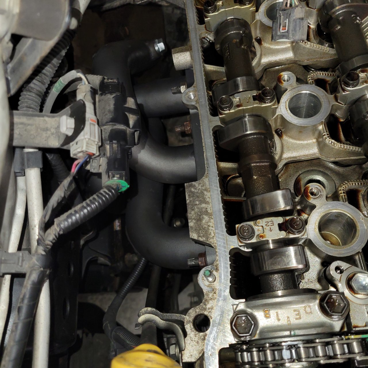

    Yup should look like this..
    If it looks like this, you're in for a bad time.

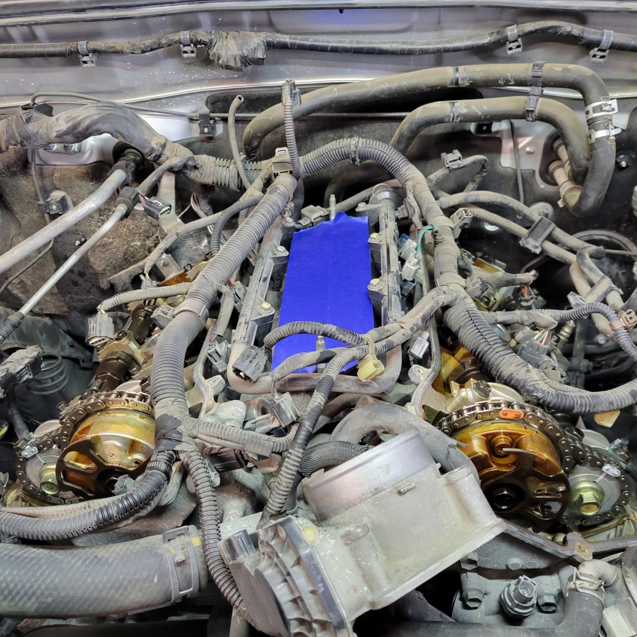

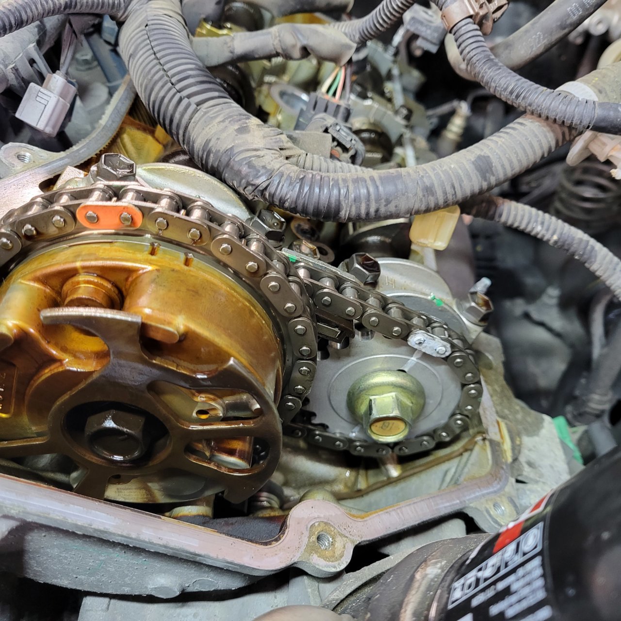

    A bunch a cool stickers, a bada ass MetalMiller Tx Longhorns grill emblem painted Hemi Orange, JBA long tube headers with o2 sims, Diff breather mod, Red LED interior lights, Fancy head unit that plays ipod n movies, Also DIY install factory stuff like, factory cruise control, factory intermittent wipers, OME nitro struts with 886x springs and toy tec top plate, JBA high caster UCA's for better alignmnet and dey beefier too, Old Man Emu Dakar leaf springs in da rear with the gear, U bolt flipper, Ivan Stewart TRD rims with 33" K Bro 2's, some bad ass weather tech floor liners so I don't muck up my interior, an ATO shackle flipper for mo travel in da rear wit the gear, also super shiny Fox 2.0 shocks back there too, all sorts of steal armor for bouncing off of the rocks like demello sliders, AP front skid, trans skid, n transfer skid, demello gas tank skid, and a tough as nails ARB bumper with warn 8k winch, I'm sure there's more

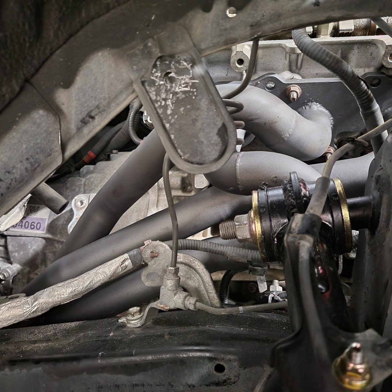

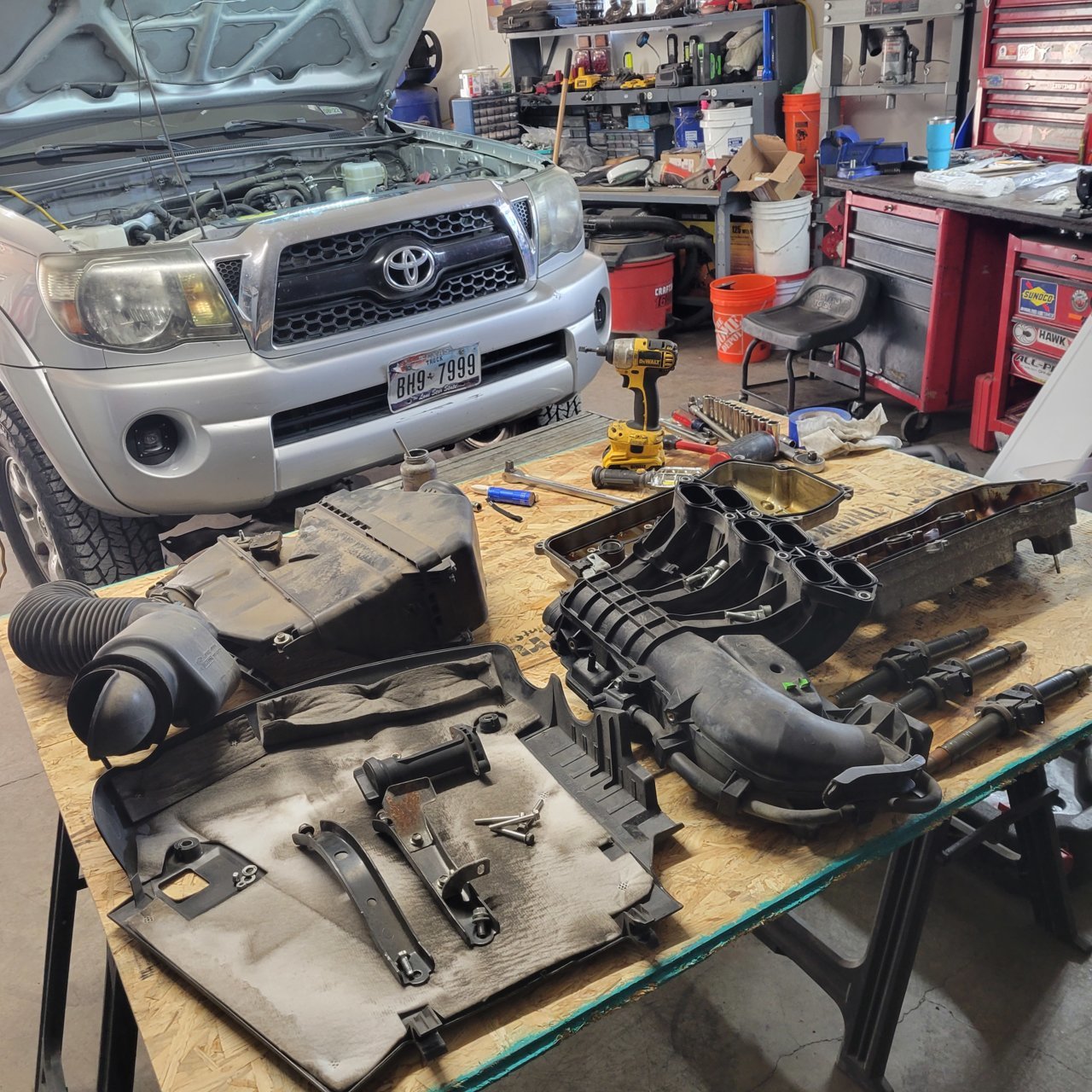

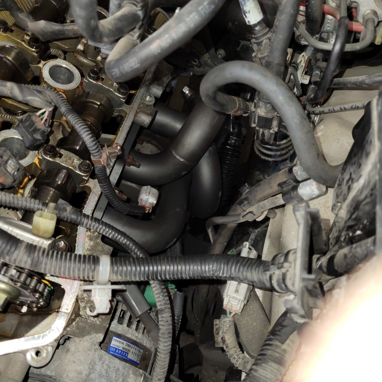

    Installed on a customer's vehicle along with URD spec U headers. Motor sounds damn good now.
    20211212_161129.jpg 20211212_161139.jpg 20211212_161206.jpg 20211213_211800.jpg 20211213_211745.jpg 20211213_211715.jpg 20211213_211730.jpg

    Nice! I wanna pair a set of those equal length headers on mine at some point too.

    I have gotten this code twice now in the last 4 months

    Love my spec u headers. I get alot of compliments and people ask how they can get the same sound all the time. I point them to URD's website and recommend the cam gears on here.

    Correct me if I’m wrong, P0022 is the code for the intake cam correct?
    I got that code a couple times as a pending trouble code, but I haven’t for awhile. It always cleared itself. Gonna tear into the OCV solenoids once the red bullets show up from the GB.

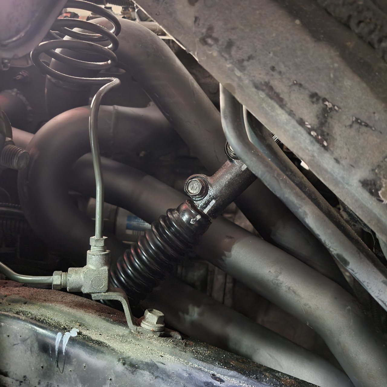

    Passenger side header slipped right in no problem. Driver side I had to throw quite a few curse words at.
    And they look super cool too being all twisted the way they are.
