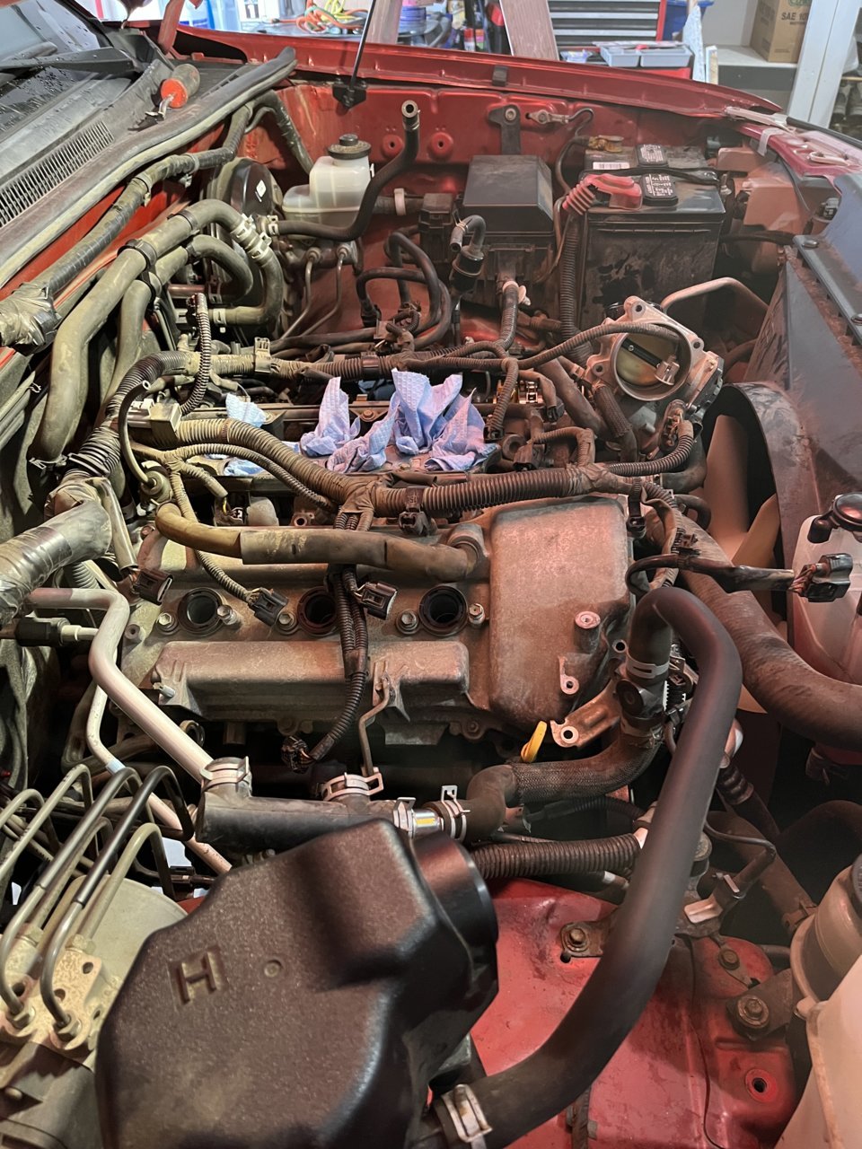

    And done... HUGE HUGE HUGE shout-out and thanks to @gpdx for giving me a hand (I still feel like I owe you, lol)
    It took us a little bit, but we got through it! Hardest parts imo was getting that stupid SAIS off and fighting with the clips in the very back. A little trick I learned/he remembered is accessing the lower bolts through the wheel well. Worked like a charm. It also didn't help how tall my truck is and not having one of those handy platforms to stand on... but I had just installed the hood struts, so it was nice not having to fight around the hood kick-stand.
    TL;DR: ANY LOWER BOLTS, ACCESS VIA WHEEL WELL

    Way less intimidating to get in there for the second time. It had been long enough that I couldn’t remember exactly how to remove some clips and tricky bits. But we got through it with the help of beer and pizza and breaks to pet dogs.
    I only took one photo. Ha.

    EDIT: I'm glad that was the photo you took @gpdx and not of me literally laying on top of my motor trying to fight those damned clips off the back of the intake LOL
