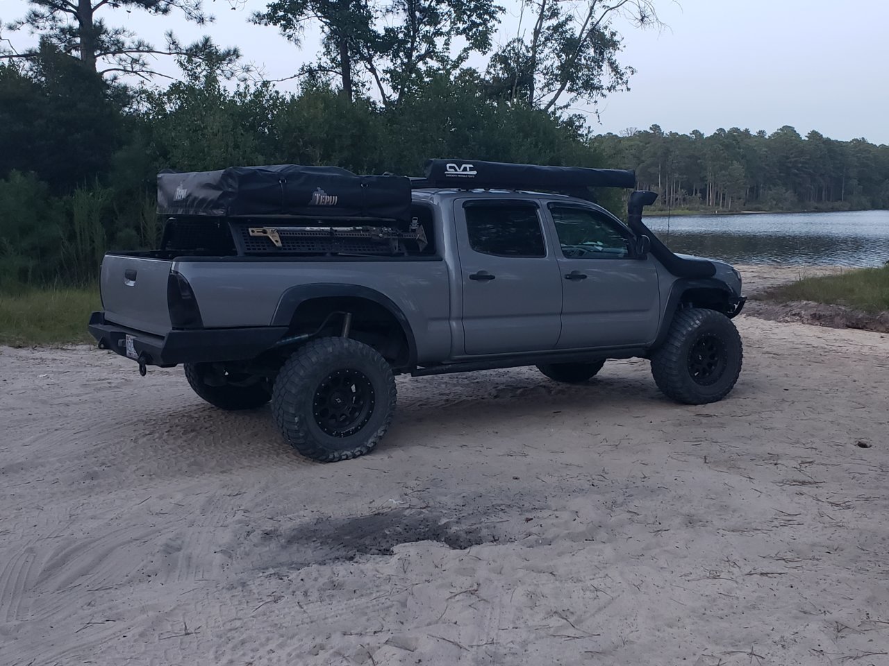

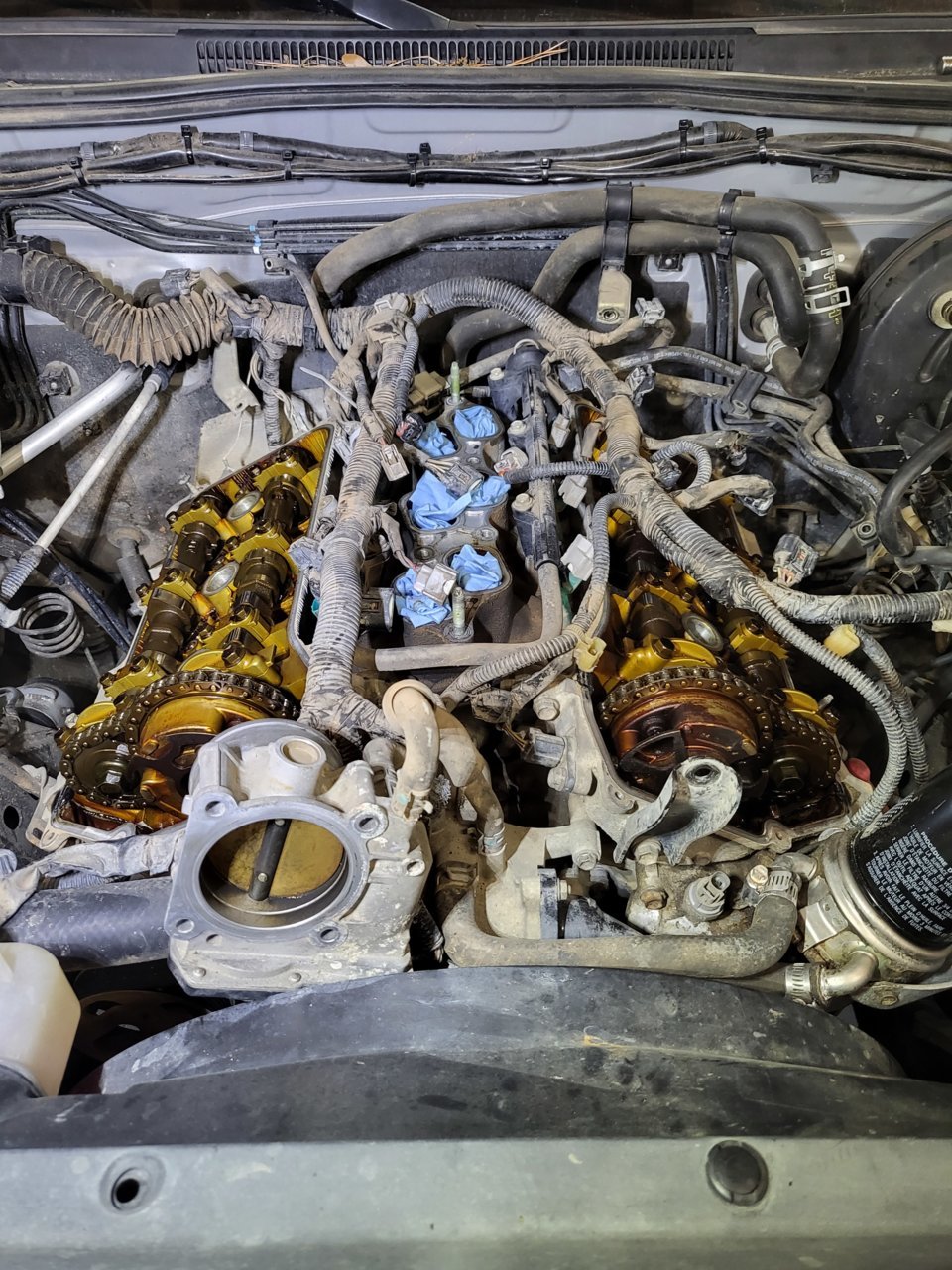

    Started last night, finished today. Not real difficult, but at 247k, I found the upper intake manifold was leaking where it meets the lower, driver side valve cover was leaking, and my plugs I did 20k ago were shot
    It's only been a day, but I'll say that she feels smoother shifting. We'll see about the MPGs with 35s and 4.56 gears

    Will do. I'm gonna burn a tank or two of fuel and crunch some numbers. Improvement or not regarding MPG, the truck just feels better. Like I did an already reliable engine a favor

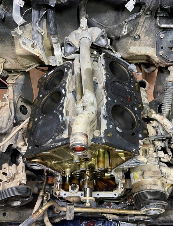

    Sheesh I'm on stock gears with 35's and about 1000lb over the rear axle!! Supercharger certainly helps ;) I average 12-13mpg currently... A re-gear will likely happen when I blow the factory ones up hehe
    https://www.youtube.com/watch?v=7yPo8E4v8Co
    Looking forward to seeing the difference the cam gears make on mine. She's all tore down now to address an intake valve leak. Adding the cam gears and URD headers when I put it back together, excited to see what she does with a fresh tune...

    she got big shoes bro
    Fuckin beauty m8 :thumbsup:

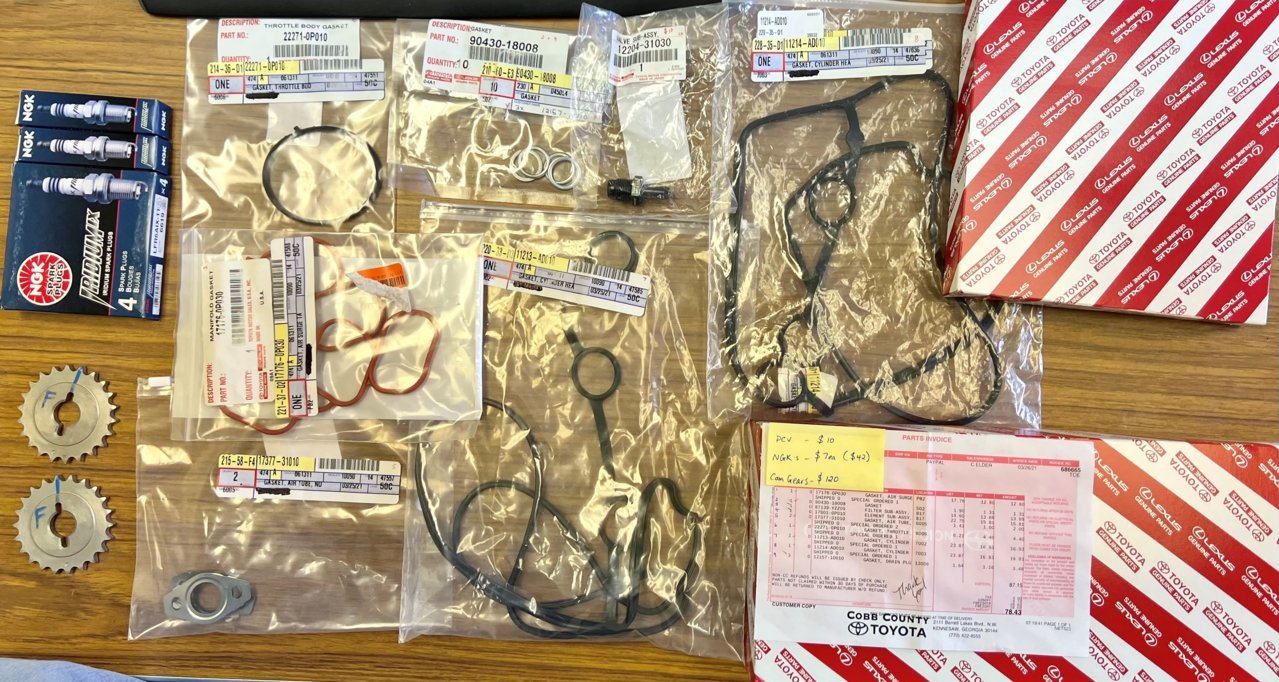

    EDIT - SOLD
    I have a set of gears and all the extras I bought to do the job, but I never got around to installing on my 2014 Tacoma.
    $180 for the lot, will ship at buyer's expense ($250 total value). Part numbers and prices in the photo, lmk if you have any questions
