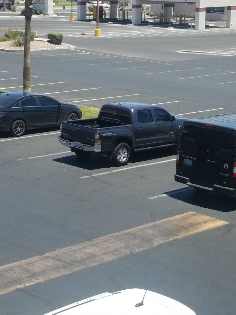

    Post a pic of your rig.

    Just a stock 13 trd offroad
