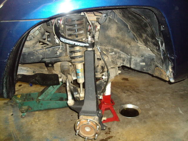

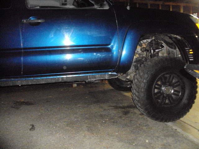

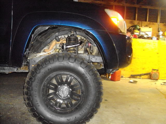

    Just got done with Mikes spindles about an hour or so ago, holy mother of Christ it...is....HIGH !
    better pics tomorrow, nitey night......

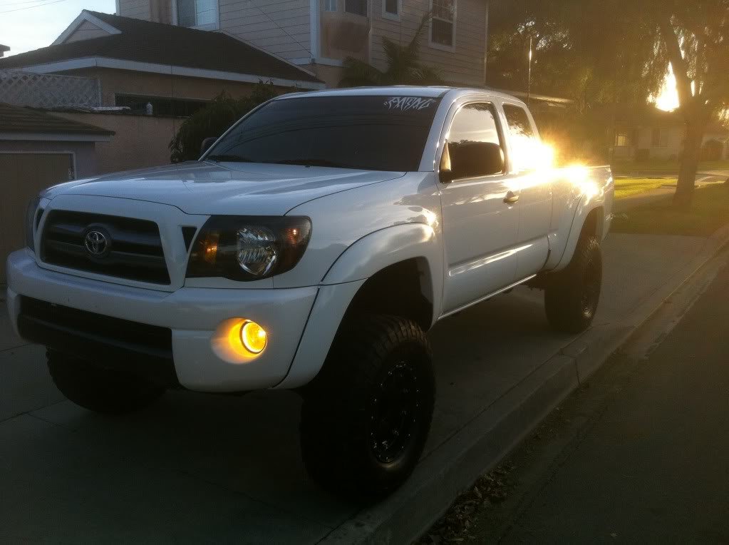

    This is how mine sits now with the C/O's at about 1.5" of lift, the Camburgs and rear Dakars.

    Thats just about perfect, nice truck BTW , we put an ALLPRO 10-pak in the rear about 4 months ago & he just picked up spindles today in L.A., he was tired of driving a stinkbug, if his shit settles 1"-1.5" i think it would look great w/slight rake to it...

    THanks :) thats what im working with, a slight front rake up front.

    Daaaamn! Son! That shit is waaay up there, but looks bad ass. I can't wait to get my spindles one day!! You're lookin good, Mike!

    Did you guys leave the front Billy's set at 2.5" of lift? That is super high! Maybe he should just put the Bily's down to 0" and get the better ride and just the lift from the spindle.

    Thanks Matt. I like the rims a lot better black, I originally wanted black rims but got a deal I could pass up on those.
    And I'm thinking about dropping the bilsteins because it is really high. I like the stiff ride though and it helps when I have dirt bikes and stuff in the back with no sway bar....

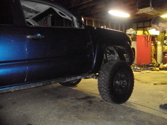

    And thanks again doug for helping me out and letting me use your garage and tools :thumbsup: I got the bfgs in my truck with your name on them.
    Here's some more pictures

    Camburg's spindles are 4" (which is what I got) Total Chaos makes some that are 3.5". They cost around $1000 for the Camburgs and they basically just move your wheel hub 4" lower then stock to give you lift, and keep stock geometry.
    Oh and they're beefy as hell...a lot of added strength compared to the stock spindles (which are the weak points in the stock suspension)

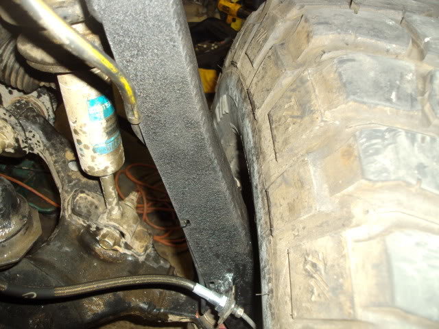

    Just checking in Mike, hows that ride now ?? Any settling yet ?? heheheh, that fucker is tall dude !!!! I shoulda stood a stock spindle next to the Camberg, abso lutely massive, but I still think we should write them with some consumer input about their "finished,no issue" product...
    with the biggest gripe, yet the easiest fix they coulda made was the hole for brakeline, total B.S.
