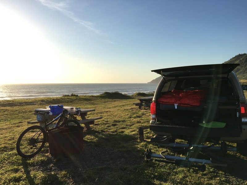

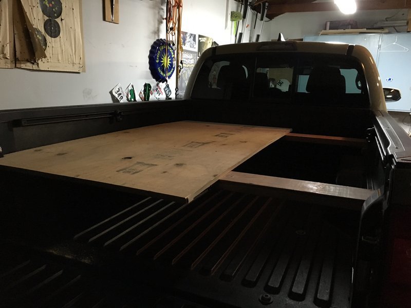

    What I ended up doing was a very simple setup that installs/removes in a minute and also didn't take any skill to build. There are pictures below, but I just got two 6"x1" planks and attached 1"x1" feet to the planks which fit into the notches in the bed. A piece of plywood sits on top. If it's just me, I just have the single piece of plywood so that I can use the other half of the bed. If it's me + 1, I add another two planks parallel to the plywood so that the platform is the full width of the bed.
    An air mattress goes on top, and for storage, I just use a plastic Sterilite under bed storage container which slides underneath. I wish I had a better picture, but here it is in action:
