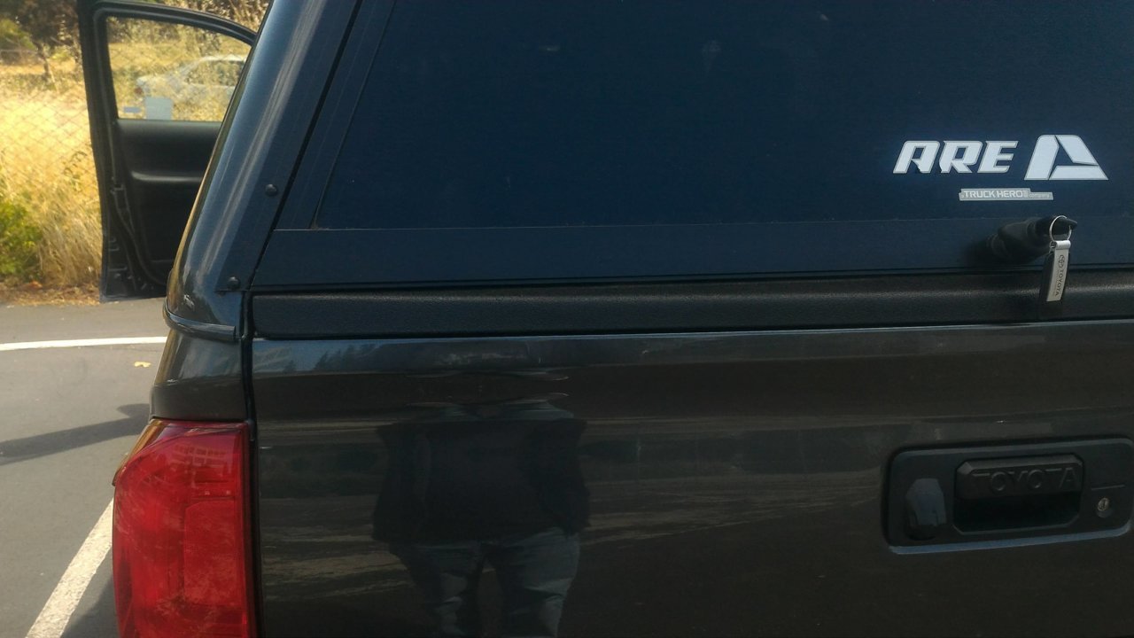

    I did few dust trips across Utah/Nevada/California, mostly canyons, forest roads and kind of desert. And found that I need to make insulation for the tailgate and rear windoor on the shell. So, it's simple to protect perimeter of tailgate except bottom corners near hinges. Also I don't know how to protect bottom corners of the shell windoor(ARE). Any suggestions? Examples?

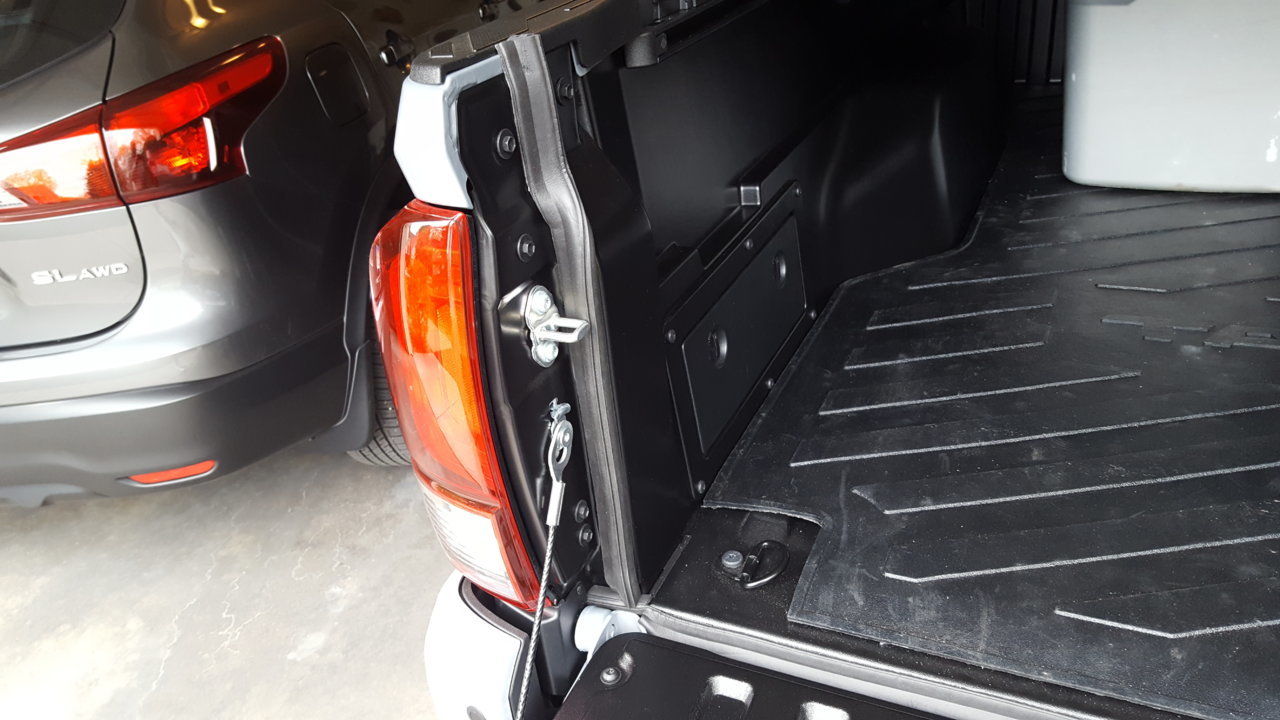

    Tailgate seal, Lund installed. But other brands out there. They are very similar(Access, Maxseal, ect). As you can see I flipped bottom and cut small piece's around hinges. Completely seals, no water or dust.20180510_175142.jpg

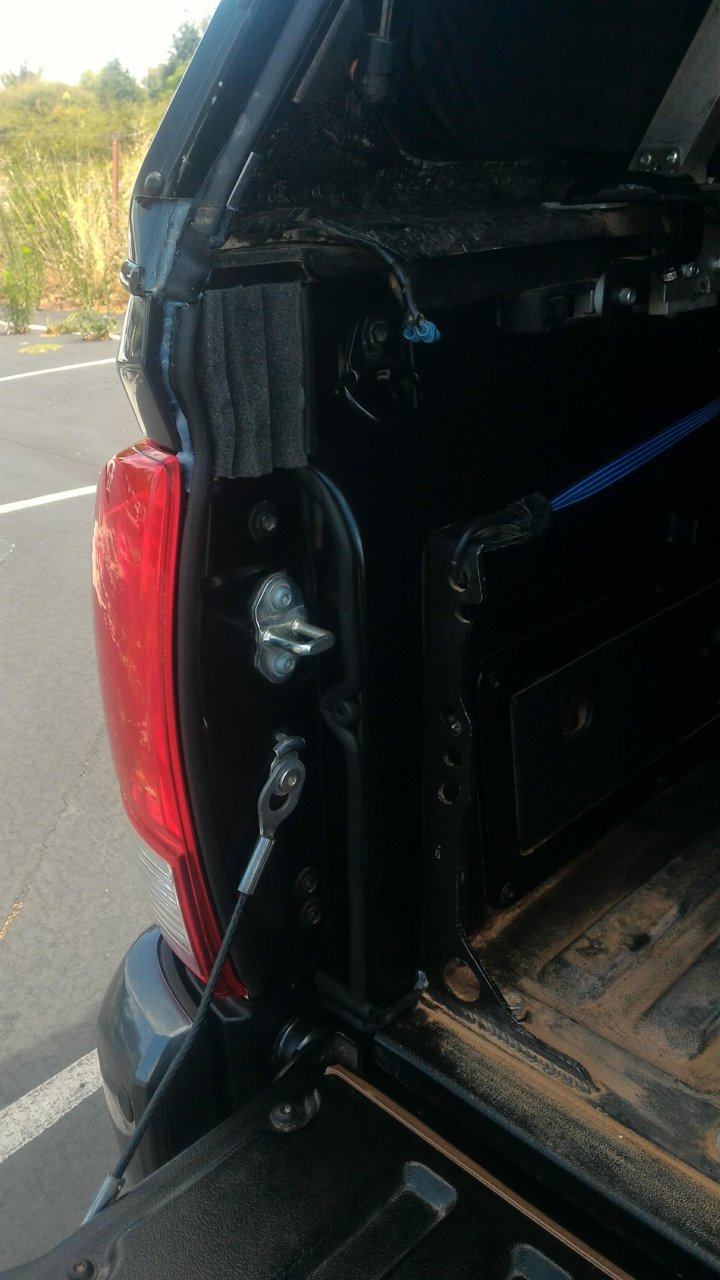

    I've used marine/auto weatherstrips and foam/glue for some areas but still don't know how to fix bottom corner of the rear windoor and hinges.

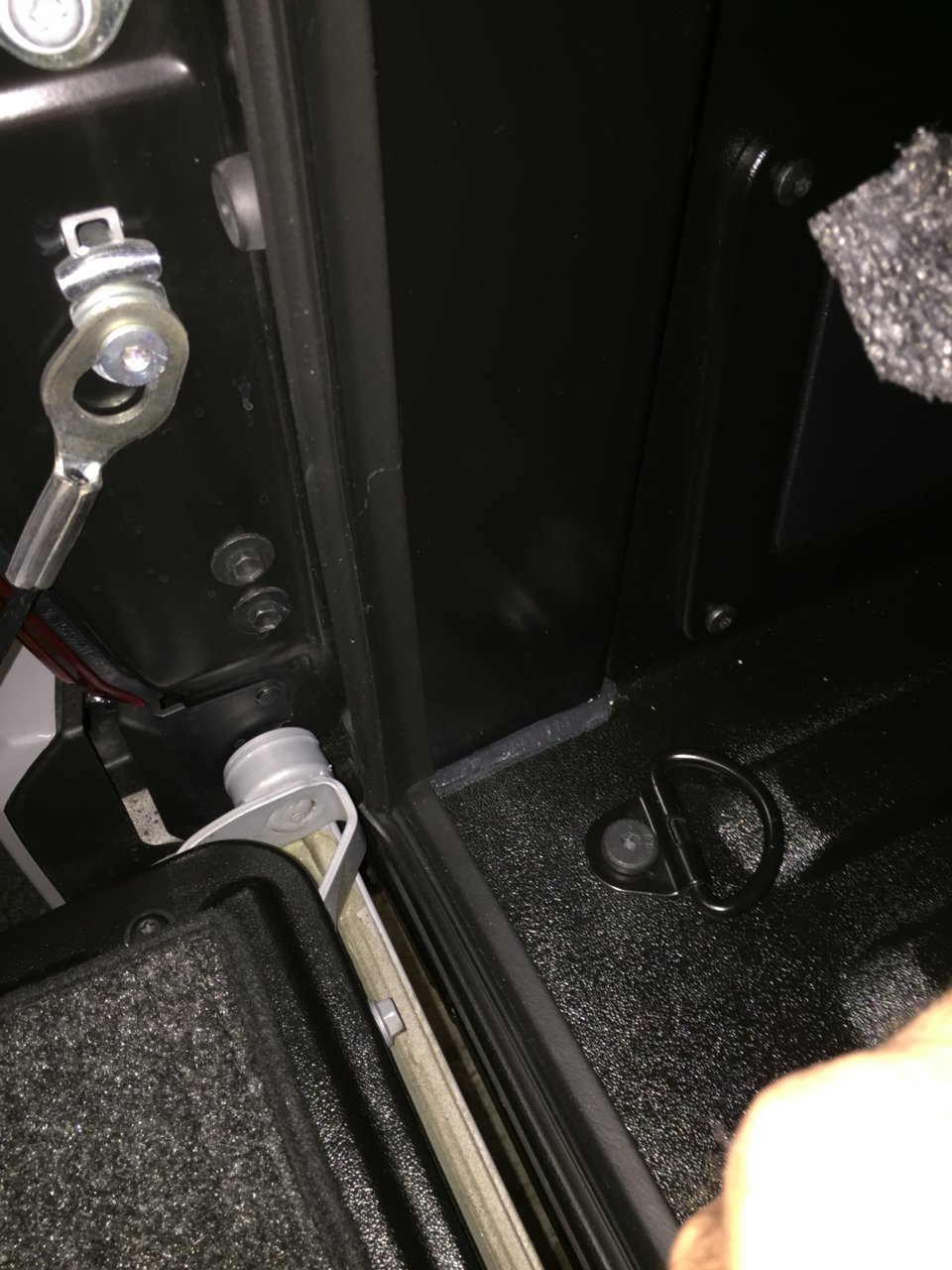

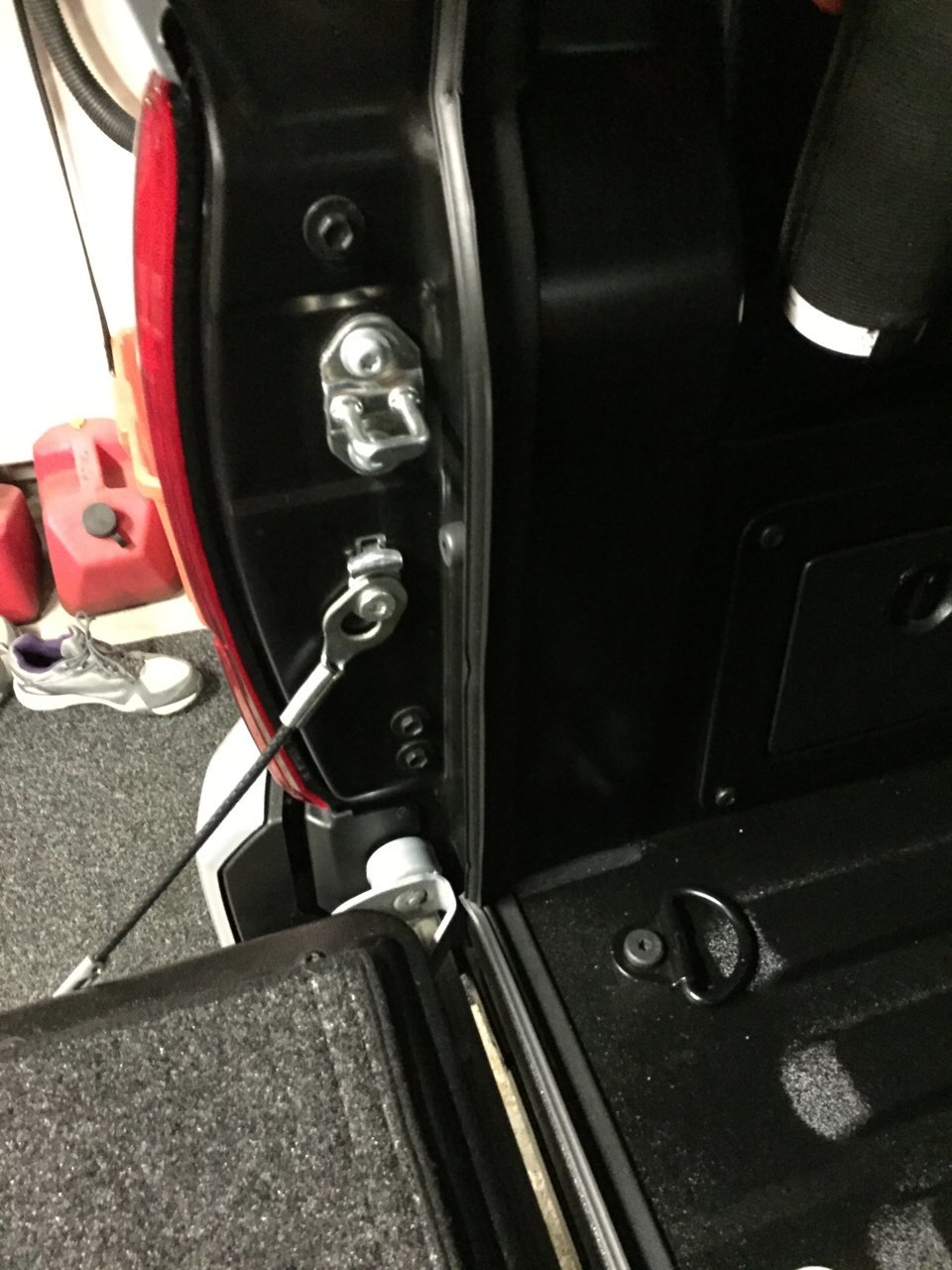

    Make sure you use black silicone sealant before you install the rubber gasket. There’s a 3” gap were the composite bed meets the metal body, a lot of dust can enter there.

    Here is a cell phone pic,3” spot that dust and water can get in. I ran a bead the day before that under the tailgate seal.72C51F25-B5F4-463B-B96A-54E27F2F86DE.jpgE4A1358E-1F12-4212-B517-A64E010446F8.jpg
