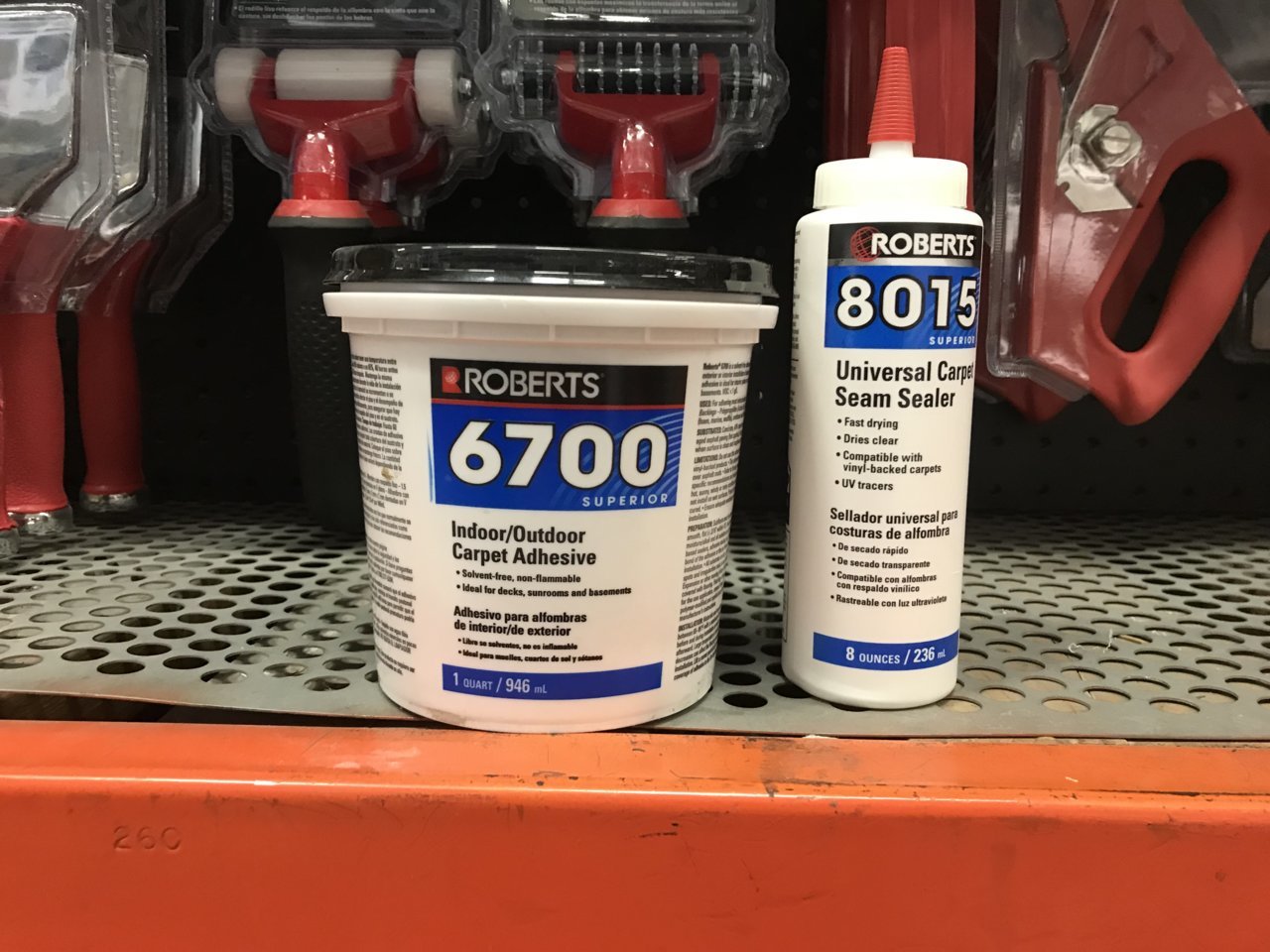

    Anyone have any tips for doing upholstery like this? I’m going to use some “outdoor carpet” from HD and adhesive similar to in the picture. A bit confused on how and where to start the upholstery

    Don’t have any experience with that stuff. Have a bunch of experience with the 3M spray adhesives. If applied correctly, the super 90 is perfect for this job and probably a lot quicker to work with.
    Spray both surfaces that will be glued, wait ~7 minutes (defer to the can) and stick them together.
    I did have one can malfunction, looked more like silly string than a spray pattern. Didn’t stick.

    I used that carpet glue to glue the carpet to my sleeping setup including the box running down the side. Assuming you're talking about using it to glue carpet to the interior of the fiberglass shell you are going to need more than that. It will fill in the uneven surface of the fiberglass and I'm not sure how well the v-notch trowel is going to spread it. Dry fit everything you can before you start gluing. Use a hard roller (like you'd use for installing sound deadening) to smooth it out well and you will probably need to somehow support it on non-horizontal surfaces or the carpet may sag before it adheres enough not to sag. Once it's on, it ought to be stuck well though. As already noted, an upholstery place is going to use contact adhesive and spray both sides then stick it together.
