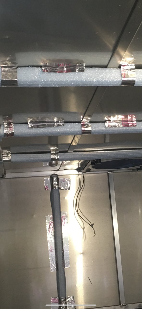

  3. Dec 30, 2019 at 11:01 AM
    #43
    Tacomabaja12
    Tacomabaja12 Well-Known Member
    May 29, 2019
    #294701
    331
    Oscar
    2012 Barcelona Red TX BAJA TRD
    Ok well if thats the case I wouldn't use reflectix not the bars, its to thick to work with. you're gonna want foam sheeting used for duct work.
  4. Dec 30, 2019 at 11:04 AM
    #44
    spitfirestu
    spitfirestu Well-Known Member
    Feb 15, 2018
    #244515
    64
    The Orange Curtain
    2017 Tacoma TRD OR DCLB
    2.5 King shock front leveling kit, 17" KMC wheels, 285/70/17 K02s, Aluminum front bumper, Snugtop shell, Rigid 30" LED light bar, SPC UCAs, Bilstein 5100s rear
    Ah, thanks! Brilliant idea for the foam ductwork sheet. Much appreciated!!!

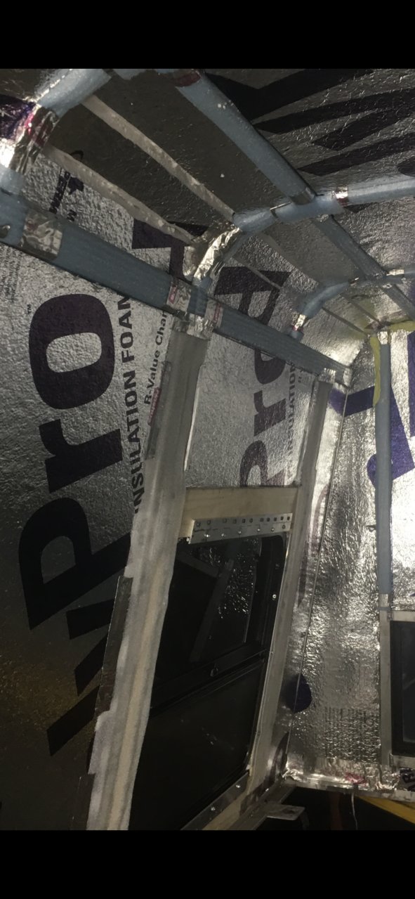

  5. Dec 30, 2019 at 11:10 AM
    #45
    Tacomabaja12
    May 29, 2019
    #294701
    331
    Oscar
    NP just trying to help anyone I can @spitfirestu, lmk if you need anything else
  6. Dec 30, 2019 at 11:12 AM
    #46
    spitfirestu
    Feb 15, 2018
    #244515
    64
    The Orange Curtain
    Beautiful! That's exactly what I was trying to workout. Looks like you found a functional way to do it. So you've got the 1" aluminum face foam for the panels, and the duct insulation around the support bars? And just hi-temp aluminum tape for keeping it on?
    I'm guessing you also used spray adhesive too.
  7. Dec 30, 2019 at 11:16 AM
    #47
    Tacomabaja12
    May 29, 2019
    #294701
    331
    Oscar
    yes to all that, then I finished it off with interior/exterior carpeting from Lowes
  8. Dec 30, 2019 at 11:17 AM
    #48
    spitfirestu
    Feb 15, 2018
    #244515
    64
    The Orange Curtain
    Awesome. What sort of spray adhesive did you use, just the 3M 77 stuff or whatever it's called?
  9. Dec 30, 2019 at 11:17 AM
    #49
    Tacomabaja12
    May 29, 2019
    #294701
    331
    Oscar
  10. Dec 30, 2019 at 11:18 AM
    #50
    Tacomabaja12
    May 29, 2019
    #294701
    331
    Oscar
    I used a combo of super 90 and super 77 as well as rubber 80 3m since it says it can be used for headliners

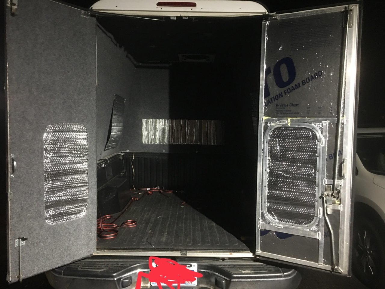

  11. Feb 10, 2020 at 6:28 AM
    #51
    lukester78
    lukester78 [OP] Well-Known Member
    Nov 3, 2016
    #201425
    885
    Luke
    97 Tacoma Single Cab 4x4
    If I had that much room to play with, the foam insulation is definitely the way to go.
    I chose to use reflectix to keep as much headroom as possible and help keep temps a little cooler in the bed when out in the Colorado sun. Idk if it makes much difference at all.
