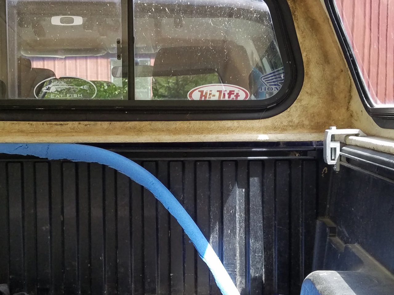

    Hey all,

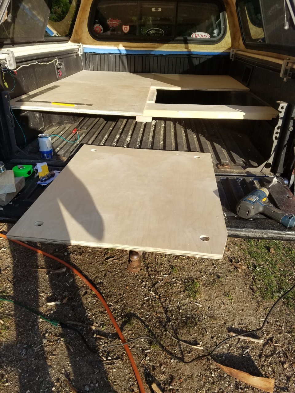

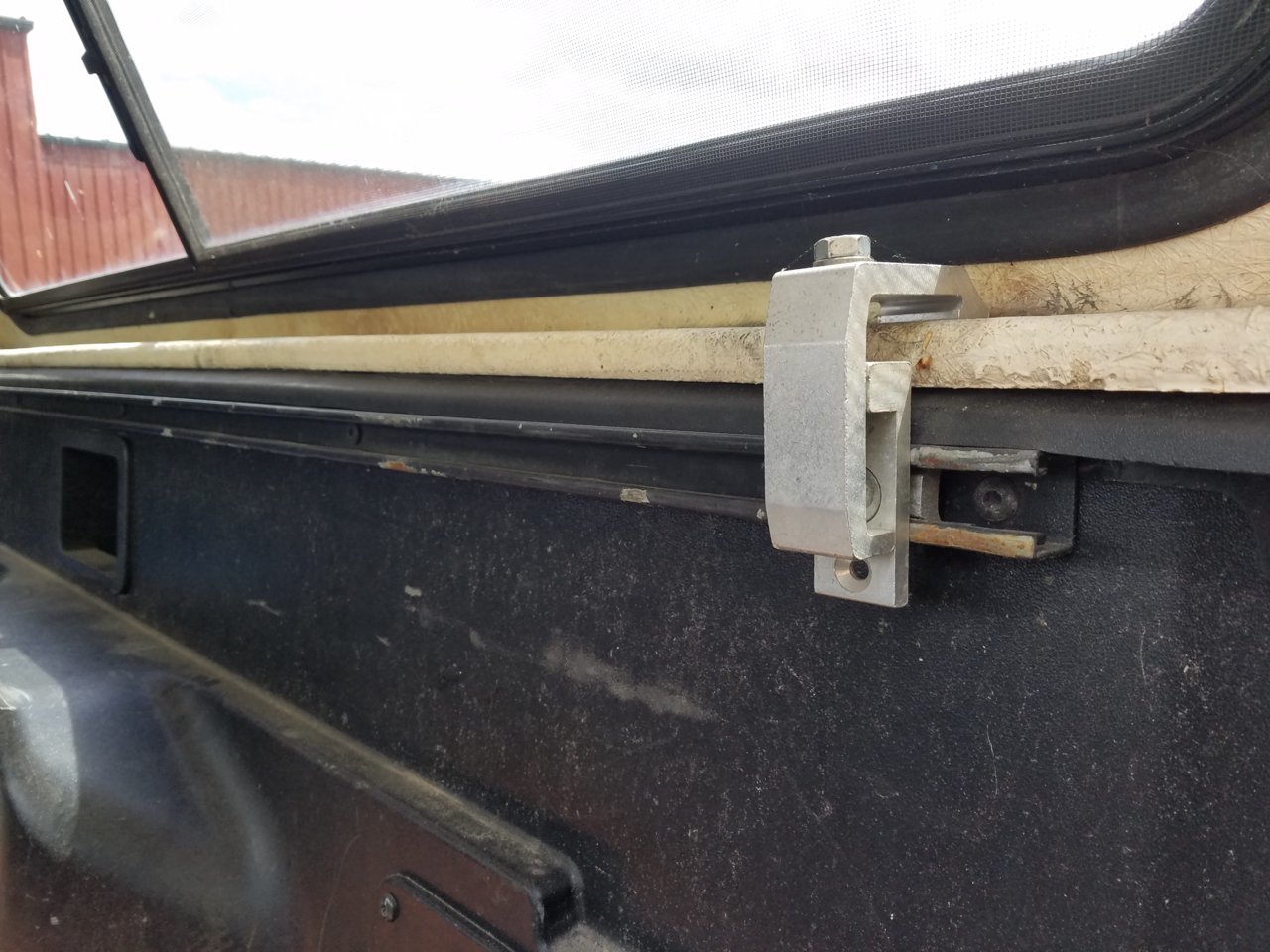

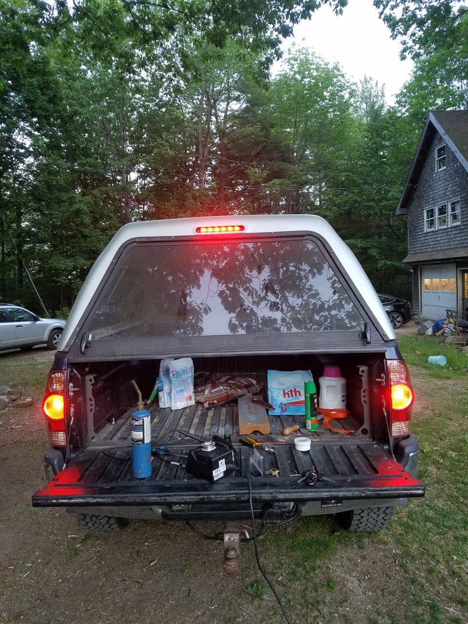

    I recently put in a Jeraco mid-rise camper top, and have the gap a the front bed wall. Currently, I have a pc of pool noodle foam stuffed in there, obviously not a long term solution. Was thinking about getting an adhesive backed foam, but figured I'd ask the people who have done this before what they've done for a more permanent and lasting solution. Pics if you have them.
    Did you also put rubber between the bed rail and bottom of the camper top?
    I'm not looking to 100% leak proof it, but enough to store things in there and keep them mostly dry if we go camping. Currently making a bed platform utilizing the bed side notches, currently waiting on corner rounding router bit to round the edges of the boards, then stain and seal. Also looking to line the inside of the camper top with something, that'll also hide the staining on the front wall (maybe leaned against a tree for some time before I bought it?)...
    I've put new locking knobs on the cap, new 3rd light with a backing plate I made on my mill, new rubber flap at the tailgate window. Added fused 12v outlet gang in the driver side pocket, with a 4-flat trailer connector to bed cap for lights.
    I did use the forum search, but didn't come up with anything specific to this in 2nd gen.
    Thanks for any insight you may offer!
    Pics of cap attached, I think...

    I have a friend who used a pool noodle on her truck cap, has been holding up in her truck for the past 2 years.
    I used a few products before breaking down and buying "the good stuff". I used this cap seal all around the bed caps, and this front rail seal to get the front rail level with the bed sides, then used more cap seal on top of that. No leaks from there anymore. Just a little from my windoors now.

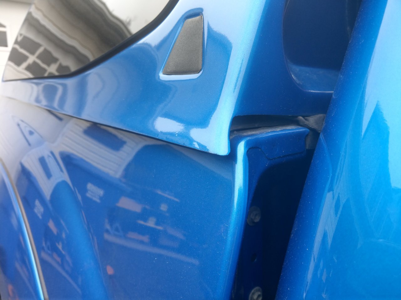

  4. Jun 1, 2020 at 10:53 AM
    Rocketball
    Rocketball If The World Didn't Suck, We'd All Fall Off
    Mar 18, 2009
    #14869
    2,118
    Scott
    Westminster, MD
    08 Speedway Blue DC Sport 4x4
    Pioneer head unit, PAC steering wheel control modual, Hard wired Sirius radio, Hard wired radar detector, Hella Supertone horns, Blacked out badges, Smoked Tails, BHLM (color matched Speedway Blue), T-Rex Eyelids, Black Powder Coated Billet Grill, Color Matched Engine Cover, Lund in channel vent visors, FJ Cruiser wheels, Leer 100XQ shell, OEM bed mat, Piezo beeper for locking doors, Tinted front side windows, Black Westin bull bar, Aires tube steps, Mini Maglite Mod, D-Cell Maglite Mod, Weathertech Digifit Floor Mats
    This is how my Leer shell fits over the bed rails.

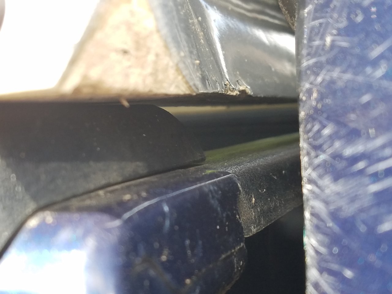

  6. Jun 1, 2020 at 11:01 AM
    pianoman8t8
    pianoman8t8 [OP] Active Member
    May 14, 2014
    #129831
    30
    Maine
    2006 Tacoma TRD Sport DCLB
    Bilstein 5100's, 285/75-16's, big steel front bumper, Jeraco mid-rise camper shell with rain gutter rail roof rack mounts 4ft cross bars, adjustable front upper control arms, small lift, cab corner delete, bed stiffeners, bed mat, yoga mat foam in tailgate grooves (knee saver), 84" roof cargo rack, uniden 980ssb with firestick antenna, wood sleeping platform on bed rail notches, led cab lights, chrome delete, 140mm computer fan on front camper top window.

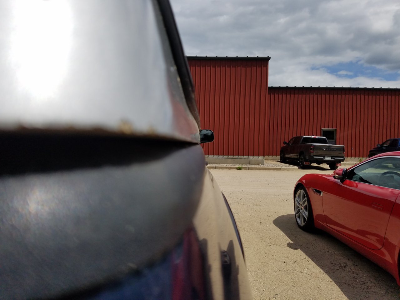

    I'm not sure if you can zoom in on it, but you can see there's no gap between the cap and bed rails vertically. Sure, it may be 1/2" to 1" or so narrower in width, but that's no the issue here. I think the photos make it look like the cap more narrow than it really is. It's fairly close to flush. The bottom of the cap is all 1 plane, with no steps or undercuts.

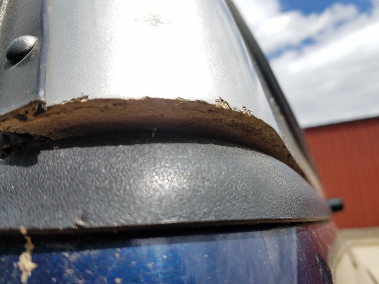

  11. Jun 1, 2020 at 11:15 AM
    0xDEADBEEF
    Mar 2, 2019
    #285037
    19,828
    2000 reg cab 4x4 flatbed MT
    I've had good luck with a garage door seal (the one that goes on the bottom edge of the door) on my not quite right sized ranger top and some 3M weatherstrip adhesive.
  12. Jun 1, 2020 at 11:28 AM
    pianoman8t8
    May 14, 2014
    #129831
    30
    Maine
    A few more shots I just went out and took. Notice the flat underside of cap, and that it's fairly flush with bed rail sides. There's just a height difference between the top of the bed rails and the bed front wall.

    Mine has a gasket that hangs over the front inside and outside - I think you're just missing that

    Correct. There's a layer of neoprene adhesive backed tape between the bed rails and the cap. It acts as a cushion and compresses/fills any irregularities between the rails and cap so there is a tight fit that should be almost 100% water tight. What you are seeing in the photo is the tape has moved a bit from vibration over the 10+ years it's been in there and has bunched up a bit.
