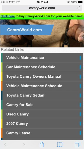

    maybe check Camryworld.com
  10. Dec 11, 2016 at 12:51 PM
    #50
    ramonortiz55
    ramonortiz55 [OP] Not A Well-Known Member
    Nov 28, 2012
    #92013
    35,233
    Ramon
    Texas
    2015 DCSB Offroad 4x4
    stock
    Nah, better ideas checking here.
