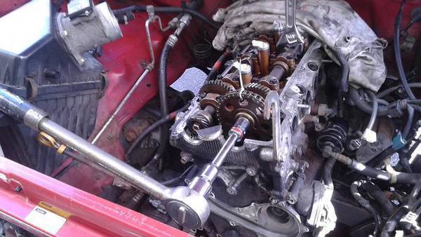

    I believe that is what the half moons are for.

    We used a breaker on the front with a 19mm and a large crescent on the cam shaft right between cylinder 2 and 3. Had to put a cheater on the crescent wrench. Came right off with one on the breaker and one on the cheater. Hope this helps someone cause we too were stuck for a long time on that one!!

    Yes, remove the half moon. I used my homemade crankshaft holding tool to hold the gear, but you can also use a wrench on that hexagonal part of the camshaft between 2 & 3.
    https://www.tacomaworld.com/threads/homemade-crank-pulley-tool.140646/
    No not try to just tip the camshaft with the gear and timing chain installed. Tipping it like that can damage the bearing surfaces.

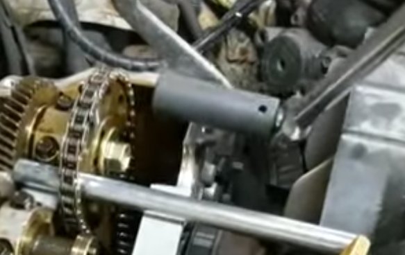

    I'm replying to this old thread because there's what looks to be a better way to hold the cam still. I don't know why this bolt is so tight when it's supposed to be installed with 54 ft-lb of torque. In this video he uses a 5/8" diameter bar (round stock) through one of the holes in the intake sprocket. He puts some aluminum plate (don't use wood) down to protect the head from being damaged by the bar. This is at about 4:00 in the video. Someone in the comments said something about making the aluminum pieces so they can't fall into engine ("The new version of my aluminium plate has two sides that hold-on to the side of the head. It won't happen again, if I ever need to remove an intake gear again.").
    https://www.youtube.com/watch?v=xc9e5fjUNJk
    How to remove a Toyota camshaft bolt (head gasket job) 3RZ-FE
    66,424 views
    Nov 14, 2018
    What Dennis Does
