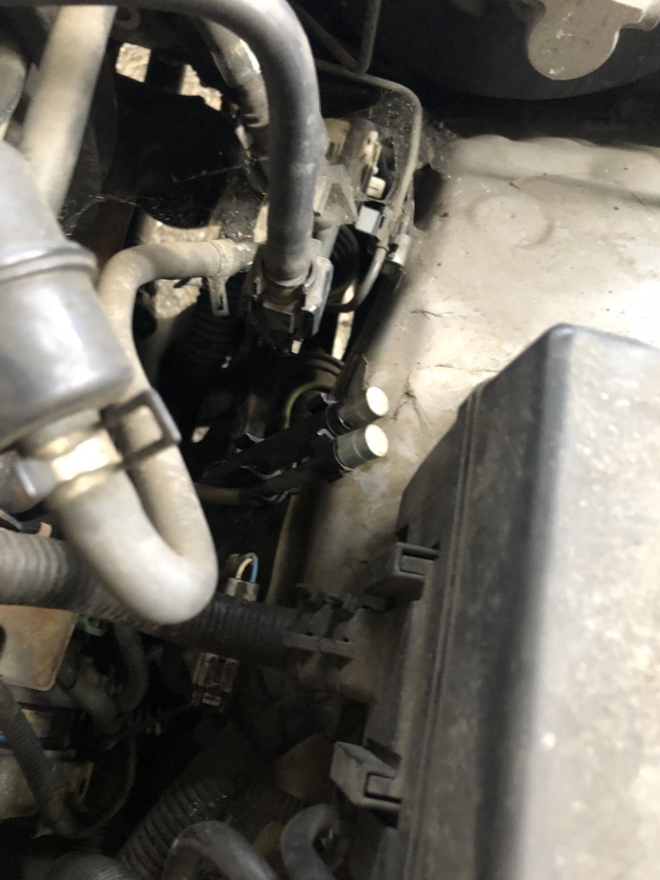

    The one furthest back is the one for the front diff. Surprise, it can like from there too. lolupload_2022-4-4_14-15-43.jpg

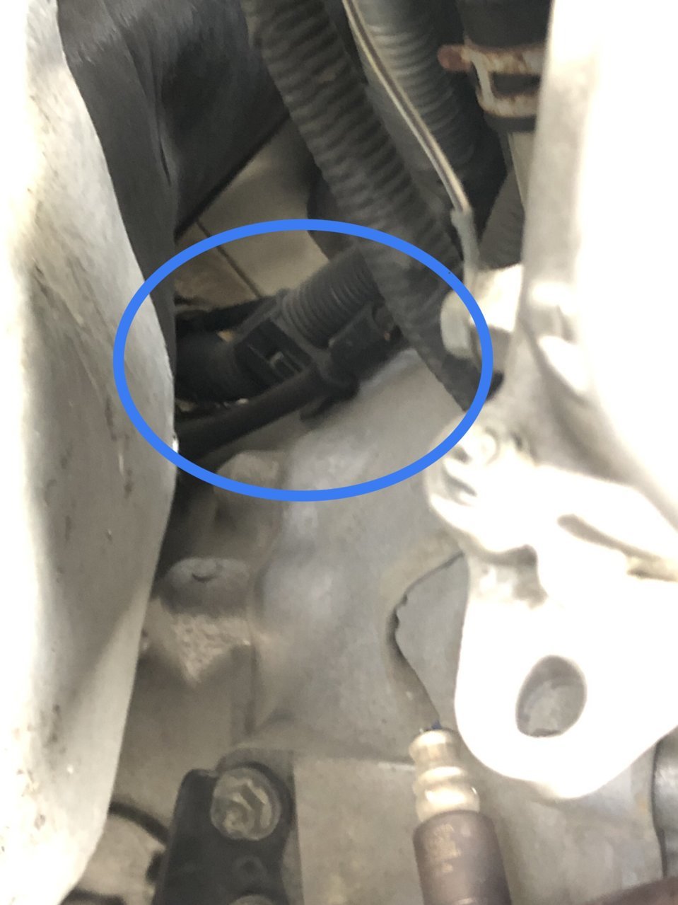

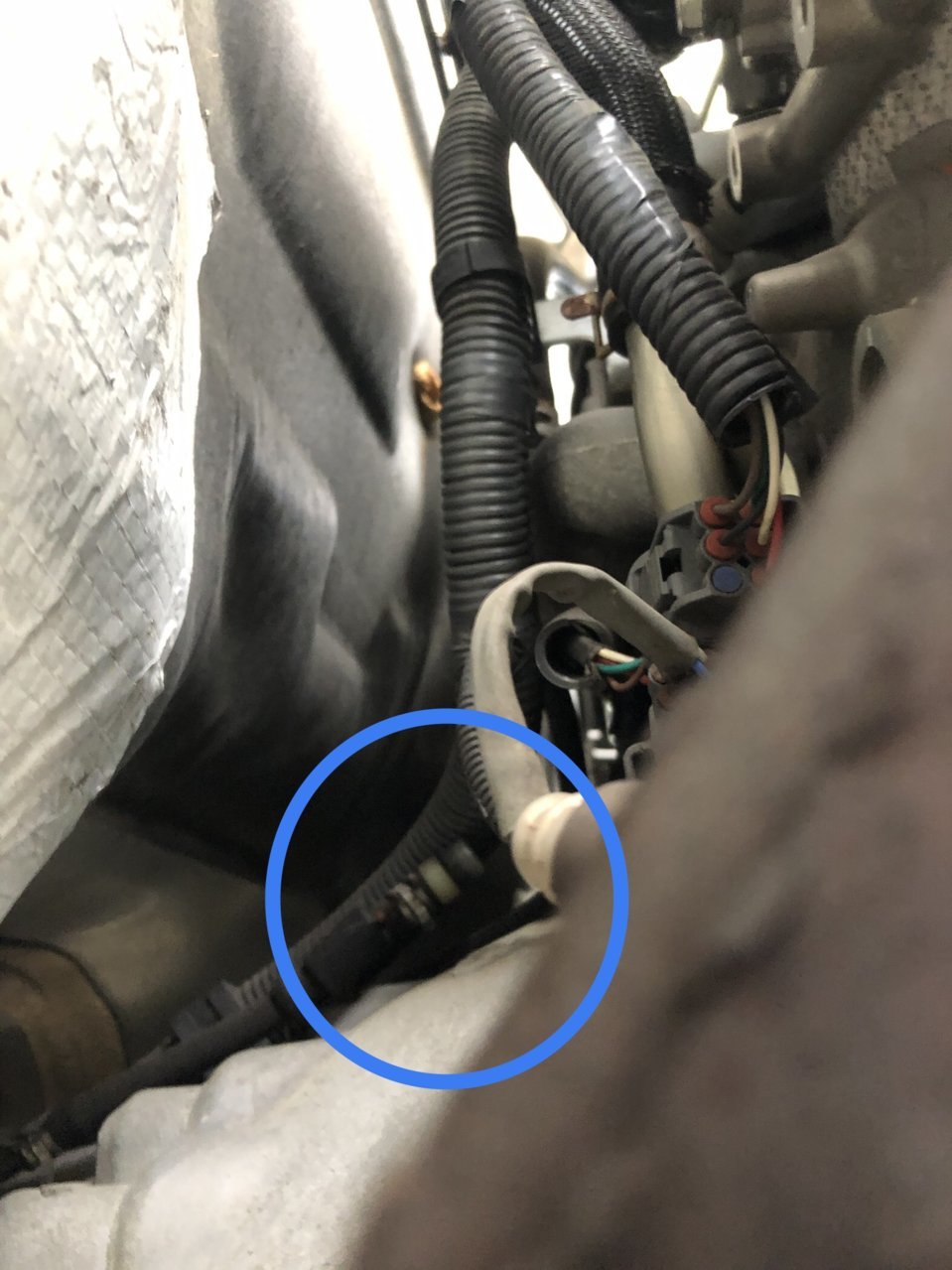

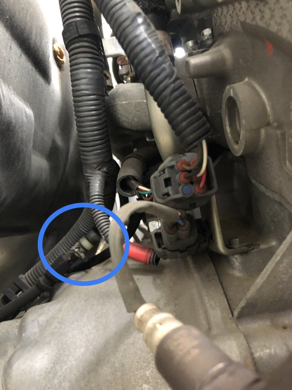

    I think I found it?
    What a task it is just to get a picture.
    Follow this line up. It’s easier to see from passenger side
    Driver side view
    Passenger side view
    SR-71A, Dm93 and 6 gearT444E[QUOTED] like this.

    If you want to puts hands on it.
    Go under and reach up by the passenger cat. Or pull the splash guard off the passenger side.
