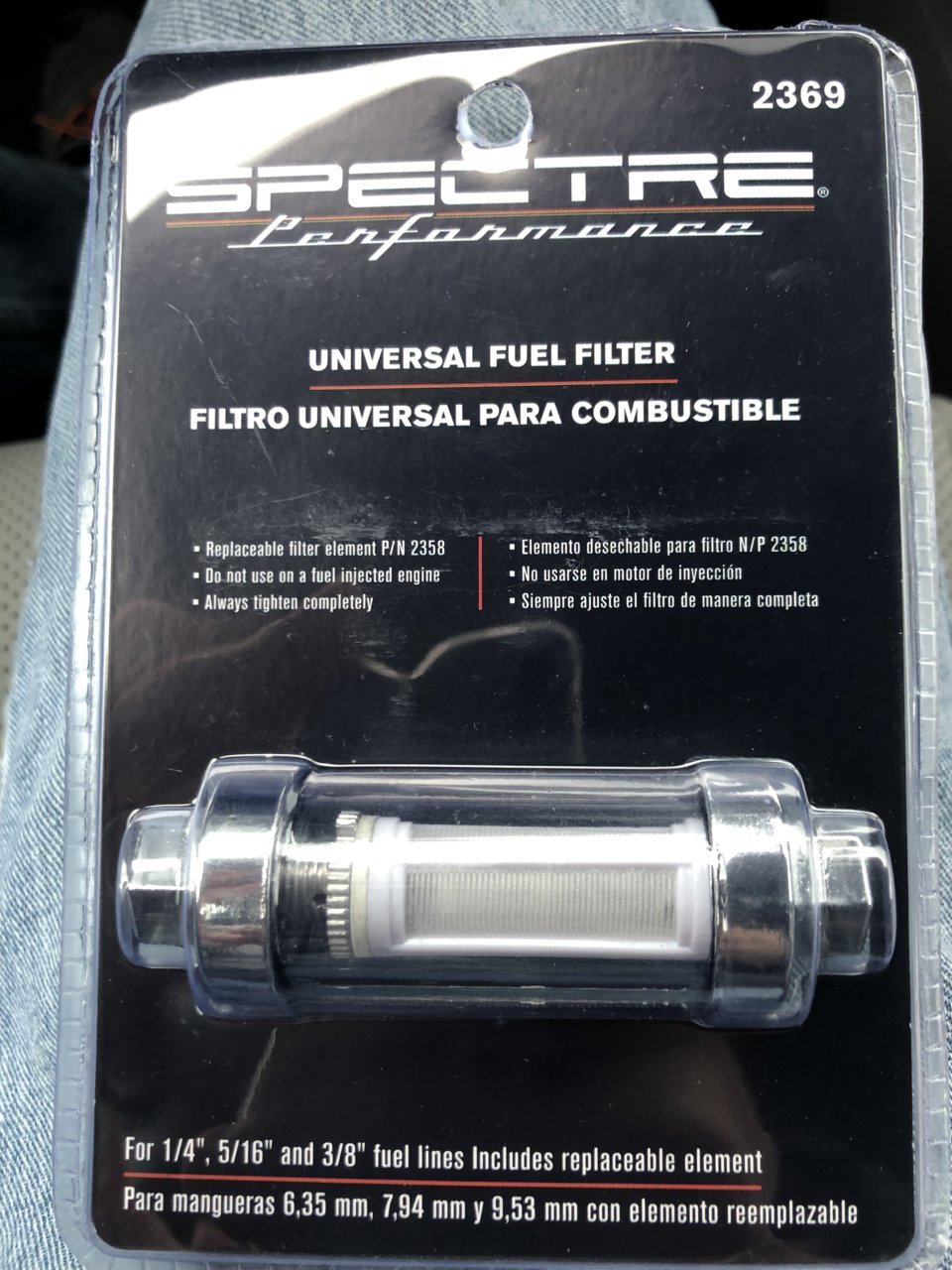

    I plan to add a filter just like the one in the link.
    Going to get the one with different fittings, it looks like 1/4” line?
    But I’m not sure, might as well get the kit and have the right fitting.

    Parts acquired. Not too confident this will “fix” the issue. But it’s worth a short.
    Try to save $25 of “new” gear oil. :rofl:

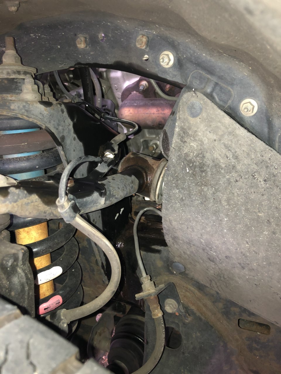

    It leaked down the fender well, onto the top of the shock mount, to the frame.

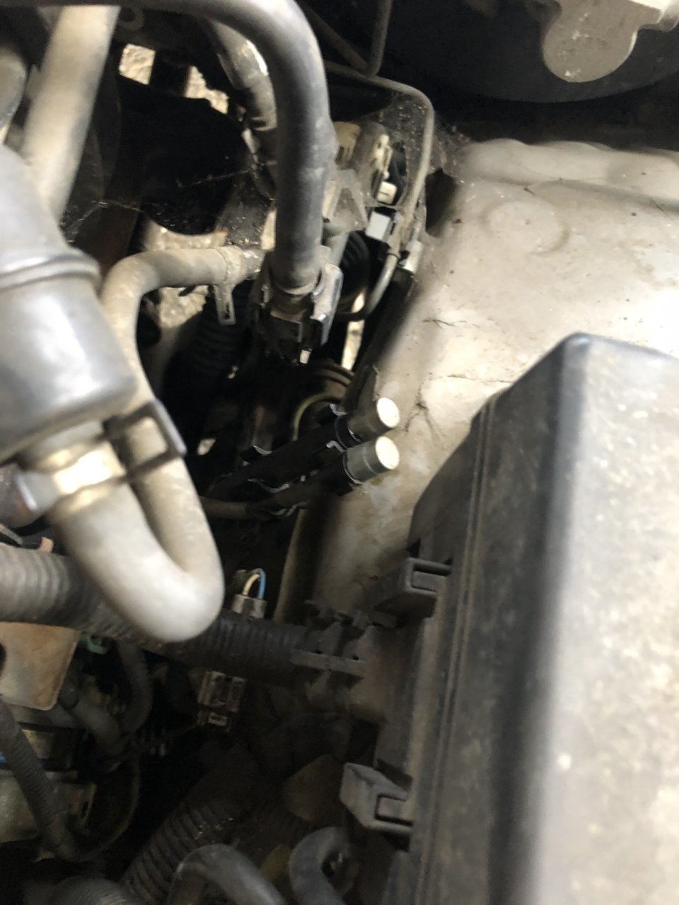

    I hate gear oil. A little goes a long ways. F1FF67E9-8808-48E9-91F2-2B25C58822B7.jpg

    I believe it's a barbed connection that will pull out yes. Comes up right by the fuse box in the engine bay. I hear you on the mess, a high elevation oil leak makes for alot of room for gravity to have fun with the oil.

    Yeah, it’s the bigger one. Toward the back. The hose is larger in diameter also.
    (For anyone in the future)
    6 gearT444E[QUOTED] likes this.
