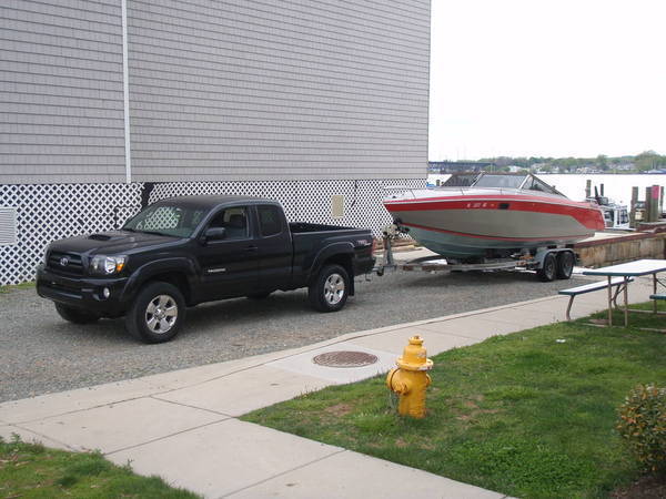

  4. Sep 7, 2010 at 8:46 AM
    #24
    Przemekmsu
    Przemekmsu Well-Known Member
    Jan 27, 2010
    #30197
    481
    Przemek
    South Jersey
    2006 Toyota Tacoma, SR5 V6, 4x4 TRD Off Road
    K&N Air Filter, WickedFlow Exhaust muffler
    I have a 6,000 lbs dump trailor that I can fill up to about 12,000 lbs that I tow with my F-250 Super Duty. Once I tried to tow it empty with my Tacoma (Which has a 6,500 hitch capacity) and the truck was struggling. Tacomas are just not meant to tow heavy loads.
