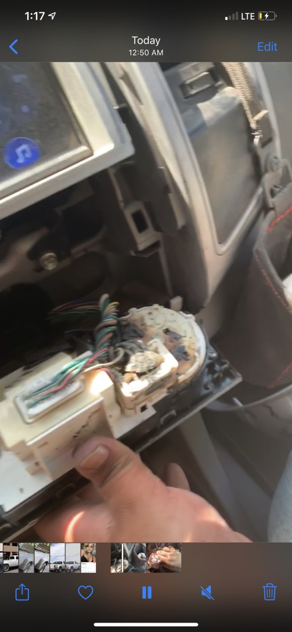

    Yes sir it burn up the ac control panel and it locked up my shift and the green indicator won’t come on the dashboard

    Also, how about a closer look at the A/C panel and the connectors?

    6 months ago I installed a new stereo system on our 2006 Taco. I went through two different wiring harnesses before I found the one that actually works. In that process, I ended up wiring something incorrectly and burnt up the dimmer switch for the gauges. The gauge lights didn't come on with the headlights. Not sure what you've got going on exactly, but you can pull the dimmer switch from the dash with a thin blade and unplug it and see if things go back to normal. If they do, the problem is the overly complicated (and expensive) dimmer switch.

    It's this little guy to the left of the steering wheel. Just carefully shove a thin knife or two in there to pry it out and then unplug it.
