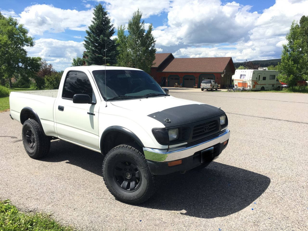

    I'm looking for a new pair of aftermarket led headlights for my 97... I've been looking at a few options on Amazon for 7x6 headlights, but I don't know which ones to choose, i dont wanna spend too much, and i want some headlights that have a lo-beam/hi-beam option on them. Don't have to be DOT approved, just led ones that are pretty good quality and preferably under 100$.

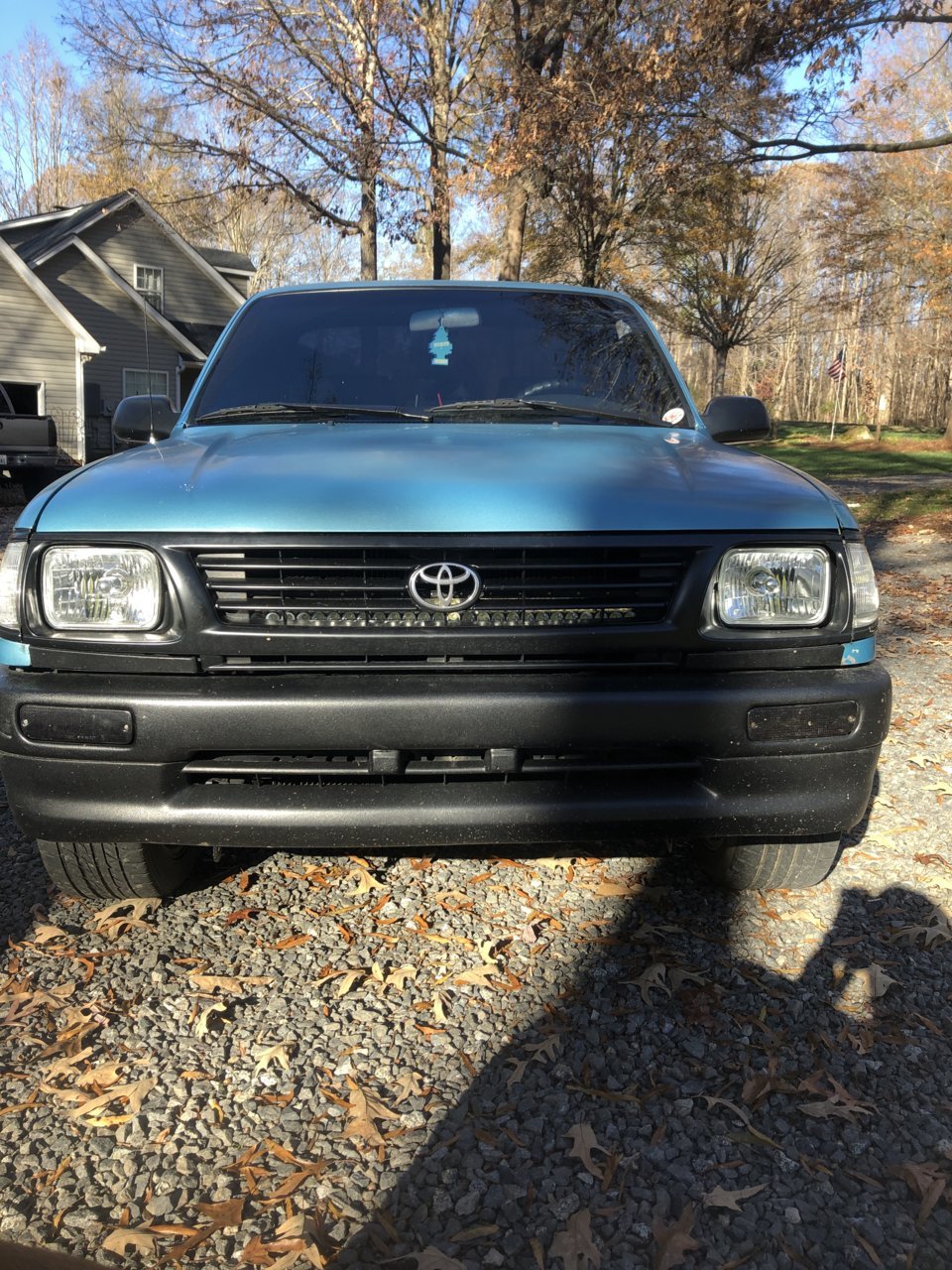

    29$ clear 7x6 housings and 29$ ebay LEDs. Ran them in every truck I’ve had always liked them
