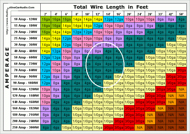

    Thanks guys. After reading that link it looks like I'll have to upgrade the alt fuse for the higher output alternator.

    Do you think that 2ga cable can safely handle the 140a alternator?

    Yes it's only a foot long.
