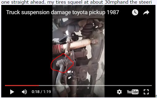

    forerummers. week ago i hit a rock goingabout 10 or15 mph and now 1 wheel points right and one straight ahead. my tires squeel at about 30mphand the steering is loose and pulls whichever direction im heading. ireplace idle arm and had truck aligned butthe aligning was done as far as allowed so its stll at a 20 degree angle and or 4 inches out of toe. iim in a 1987 pickup 22re 4in skyjacker with 33

    Could've bent/stripped a tie rod end and/or steering box is messed up.

    You might want to lube up your steering. It sounds like bearings crunching

    If the alignment tech who worked on it didn't tell you what needed repair, you should ask for your money back.
    And he should be technically retrained if he doesn't know, service retrained if he does know and didn't tell you, or just fired for incompetance.

    here is your problem, you have some play in you pitman arm, if you look when your helper does the side to side you will see the slop in the ball joint.
