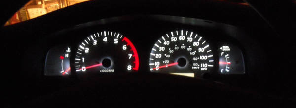

    This is what mine looks like with white leds.
    Originally, I tried to put some cheap incandescent bulbs in and was very unhappy with the results. It may work ok with the orange condom on them, but with out it, it was more of a sickly yellowish-orange light (warm side of the light spectrum) - about the same as my headlight light you can see in the top corner in the pic above.

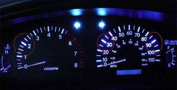

    Are these the "hot spots" you guys have been talking about?

    ^ yep, and by the 6 in the tach...

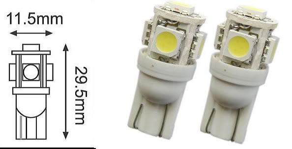

    So in order to still use LEDs but not get these "hot spots", what kinda LEDs do I need to get?

    I don't see why not they will fit. The only thing is check the gauges before you put everything back if you have any dim spots flip the bulb housing they should work both ways I had to do this mine. if it don't light after just unplug the bulb from the housing and plug it in the other way it should light.
    Good luck with the install.
