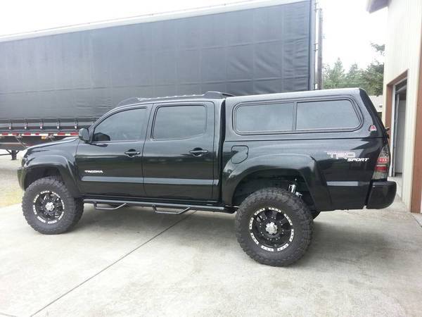

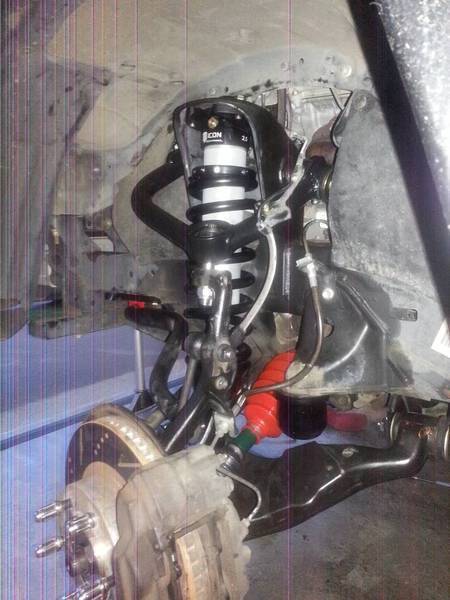

    My lift is Icon Adjustable coil-overs:
    My tires are 295/70r17 (33.26x11.61) Toyo MT's

    I took the mud flaps off the day I got it lol. I plan on doing a little mudding here and there and I want to go with the black on white look. And that's a nice truck man. Where did you get the coilovers and what kind of lift do you have in the rear?
