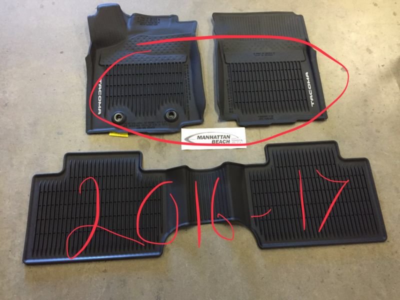

    166A36CA-3811-4927-B482-83E65829B315.jpg D2C5BCC4-97FD-4BCA-87A2-7E7F08904EA3.jpg I have a 2017 and want to know if anyone has added the tabs to the floor board like the 2018s do? It’s really annoying having that slide around.

    In my opinion not worth it. The stock floor mats leave a lot to desire. Yes they look decent and nice with the Tacoma lettering but perform horribly. I replaced mine with 3D Maxpider Kagu Floor Mats. They don’t move an inch and retain all the water, dirt, sand, mud etc. A lot of guys like weathertec floor mats. I have them in the family wagon (suburban) they are to stiff and don’t fit as nice as they should.

    Use a drill and a couple screws.

    Expense and hassle? Its $10 and few minutes of your time. The stock floor mats slide around a good amount when passengers are in because their are not clips to hold it place - very annoying for the driver and the passenger.

    Yes You could order the clips from the Dealer - take off passenger side door sill - then You pull up part of the carpet make a slit then put clip through - I had to do it on several Hondas

    The first ones that I linked, you just screw them into the carpet and then cut a hole in the floor mats...the second one I linked it looks like they require a hole to be poked first according to the comments. Still should be very simple.

    Also looking for a fix for this. Is there an oem part # for the round grommet-like piece that is attached to the mat? My '18 has the parts you "turn" already in the floor but apparently my mats are an older version.

    I just bought the extreme duty Velcro at Home Depot and my passenger side mat hasn't moved since.

    I used the Vw ones off ebay. The base screws into the carpet nice and it holds great.

    Same always happened on my passanger side. I ordered these without the cutter and just used a drill bit to make the hole in the mat. They work great.

    My 18 came with these mats and they are just ok.
    1. They are thin
    2. They squeak for some reason
    3. The edges are curling
    But they say Tacoma on them... So +10 hp lol
