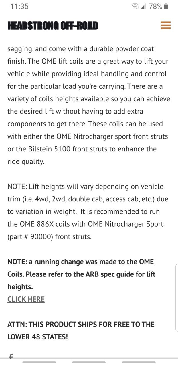

    The 886/5100 combo, with front aftermarket bumper, is used by Taco, FJ, and 4Runner owners. One 4Runner said he preferred the ride with this combo over OME Nitros. I didn’t do extensive research, but from the threads I read, no one expressed issues with this combination. Headstrong has a motive to recommend against this combo - sell you more expensive products.

    OME 886 with the adjustable 5100's set to 0 lift and plate spacers on each side to correct the lean and to give you the extra bit of lift needed. Ride will be alot smoother than if you were to set the ring at the 2nd setting.
    The 886's can be paired with the 5100's. This has been my setup for the past few years. Have plate bumper and winch. Many people have this suspension setup with no issues.
    Also, Headstrong RECOMMENDS the Nitrochargers to be used with the 886's. They do not say anything about not using the 5100's or issues that might occur with using the 5100's

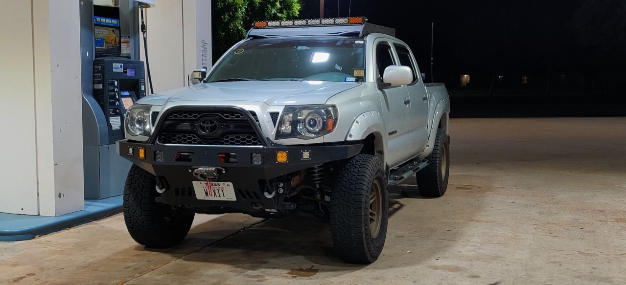

    In regards to heavy 700+ lb springs and 5100's, I am running a 725ln spring on the 2nd notch on 5100. Rides like butter, even with all the armor and gear. Only got about 2" because of the weight.
