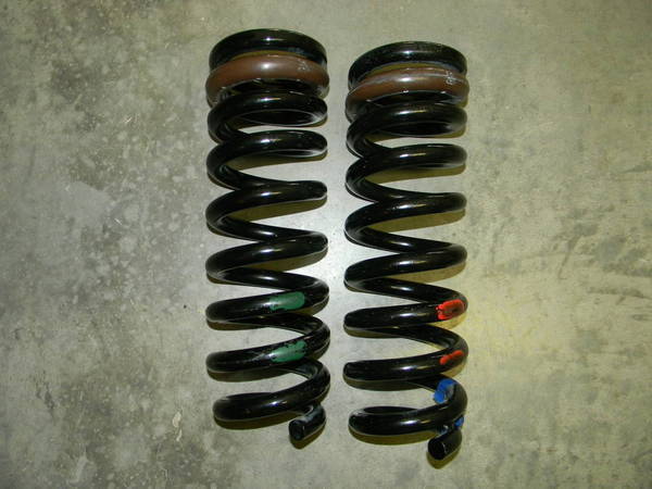

    Short answer is no.
    Coil springs for Icon, King and other adjustable coilovers are ground flat on the top and bottom.
    The stock springs (and OME 88x) are only ground flat on the top. The bottom is an open coil and the bottom seat of the Bilstein 5100s are designed for that open coil, not a ground flat coil.
    Look at the differences of the bottom of the springs.
    Open Coil at the bottom
    Ground flat at the top and bottom
    Toytec makes an adjustable adapter for 5100s that require you to have a ground flat coil.
