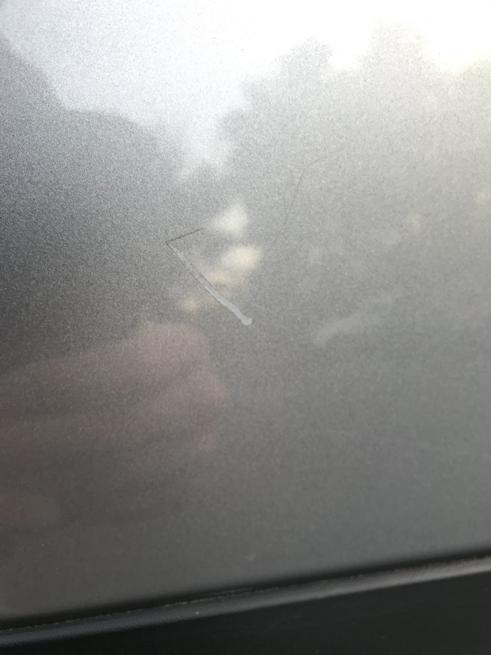

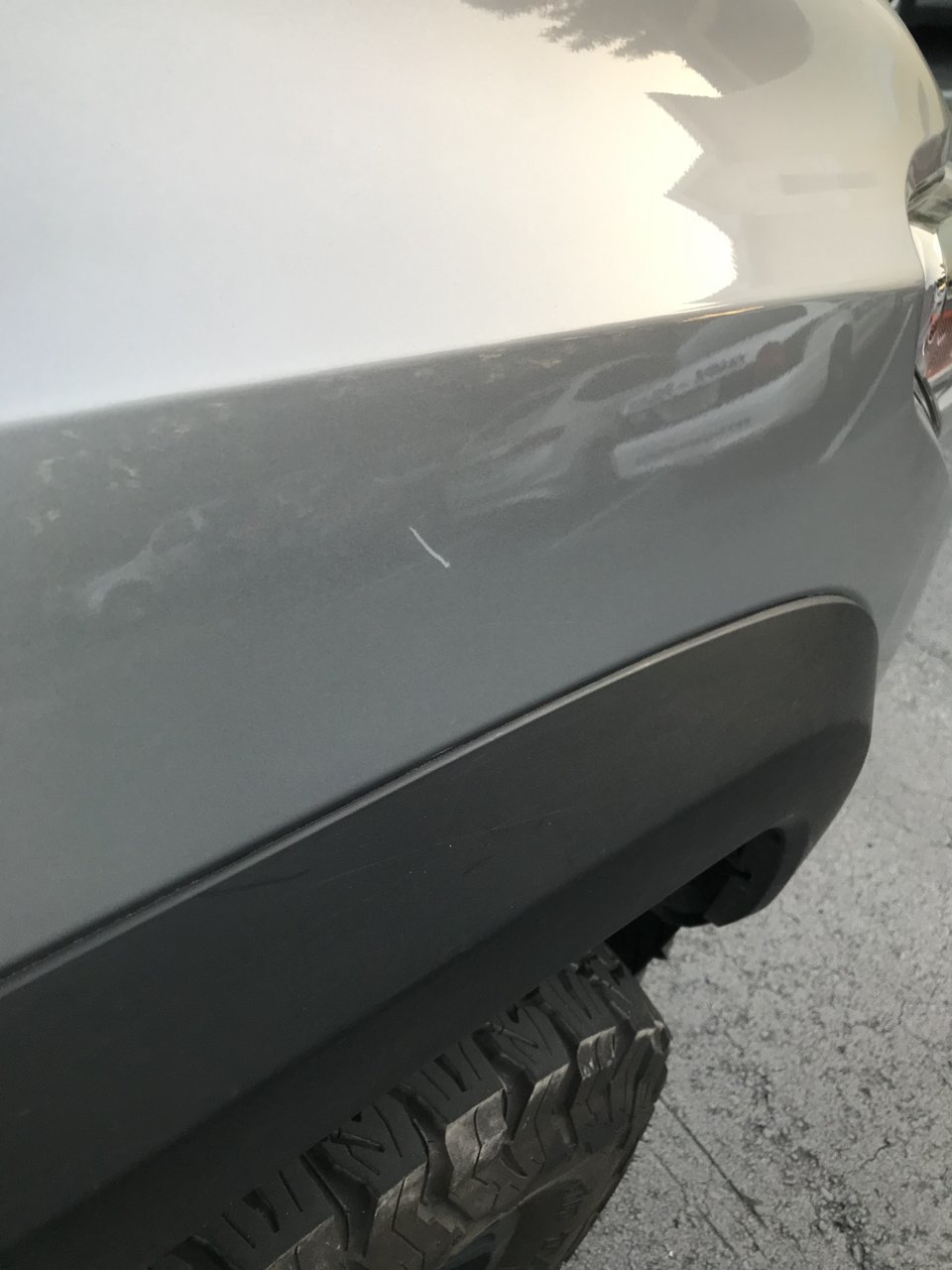

    Scratch in my fender that I got like my first month of having the truck. It’s pretty deep but not to bare metal. It’s been there almost 2 years and just don’t like seeing it.
    Can I use one of the paint touch up pens from the dealer for this? Are they hard to use?

    Yes you can and no they are not hard to use, however they will not make it seamless, just better.

    Use really light coats and let it dry between, don't try to cover it all at once. Buff it when done and it will be a lot better.

    You could try buffing it out first? A lot of should disappear to the point where you don't notice it.

    It seems pretty wide and deep for buffing to have much effect. Also forgive my ignorance wouldn’t the buffing go out after some washes and need to be redone with some compound?

    Agreed, but if you lived with it this long, knocking down the edges and the light scratches on both ends might cure it for you?
    No. You are buffing the clear coat, so the effect will not fade. I stayed away from polisher discussions for many years but getting pinstripes on the Taco made me try it out and made me a believer. Some of the other stuff that I fixed has been crazy. I am upset that I didn't take before an after pics.

    Definitely light wet sand and buff first. Thatll get the light surface scratch out and get the gash down in size a little bit. Touch up after. Probably will need two or three passes with touch up.
    If you wanna do the touch up correctly, grab one of these well pens and get touch up from the dealer corresponding to your paint code.

    buff, then use pen, buff again. and hope for the best, It'll get better but not as it used to be.

    I've got one of these and while it works great for filling small stone chips, not really for scratches. Buffing is not the answer either, too deep. If you really want it fixed, take it to a good paint repair shop.

    Looks like OP's Tacoma is Silver Sky Metalic, if so forget about Dr Color Chip. I purchased their Silver Sky Metallic a couple weeks ago to to fill a tiny store chip and it wasn't even close to a match.

    ide say wet sand and polish but if you haven't done it before then maybe not, its pretty easy to burn through the clear if your not careful.

    You are right, no job for an amateur. I may be wrong but from the photo, looks as though he's already through the clear.
