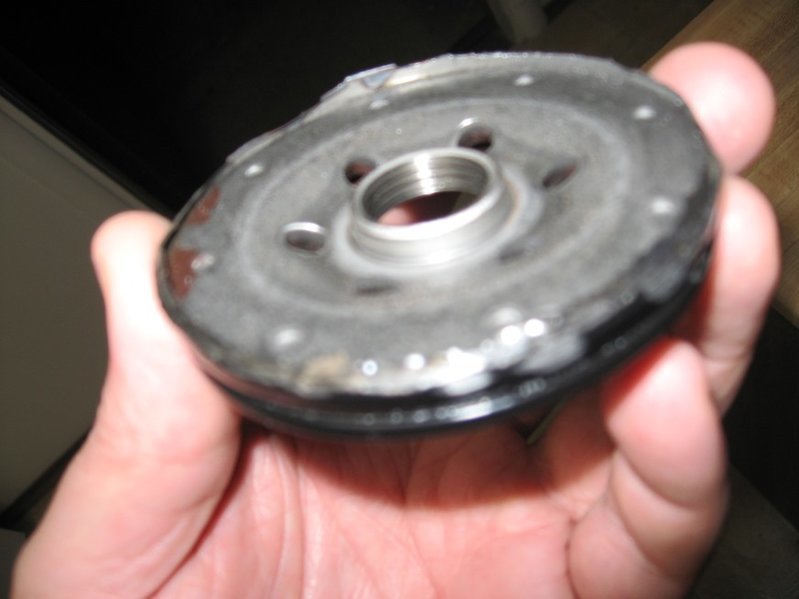

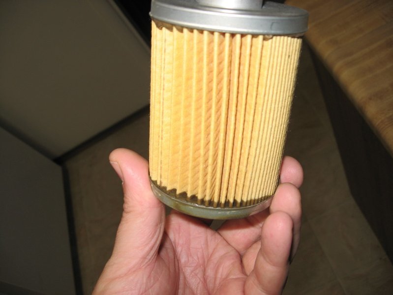

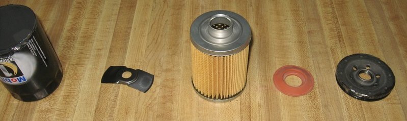

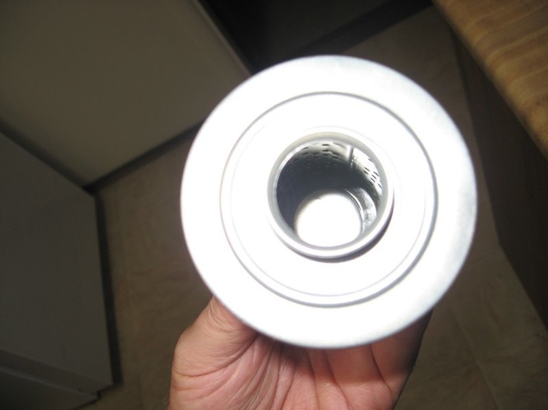

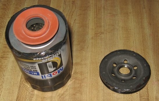

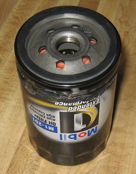

    I bought the M1-201 filters for $3.25 apiece (Rock Auto wholesaler/closeout) so it was an easy decision to cut one open, to check the *actual* condition of the filter, and for S&Gs. This is the first time I have cut open an oil filter so it was pretty fun. Remember these filters are now over 10 years old. Here's what I found:
    Mounting plate
    silicone anti-drainback valve (red)
    filter element (beige)
    small leaf spring
    metal canister
    Everything looks to be in great shape despite its age. The mounting plate is extremely heavy, probably 3-4mm thick steel -- when I finally cut it off using a grinder, I was shocked how heavy this part is. The anti-drainback valve is still soft and pliable. I pushed on the filter element with my thumbnail and really gave it a good check - the filter element is not brittle or cracked or disintegrating in any way, and the glue is still soft between the element and the metal ends. The leaf spring at the bottom of the canister applies a considerable amount of pressure, which seals the ADBV between the filter element and the mounting plate. The core of the filter element is a perforated metal tube, which can easily take the pressure from the spring. I thought about cutting the filter element apart but I want to wait until my dad visits again so we can do that together. He spent 38 years as a commercial aircraft mechanic and he taught me much of what I know, so we like to share this kind of stuff with each other.
    I have seen internet photos and videos of other brands of oil filters being cut apart. This Mobil 1 filter is not the very best available, but it is easily one of the best designs, and a good compromise between price, quality and value. I'm glad I bought so many for so cheap. Now I have 4 left and will use them on the Corvette with confidence.
