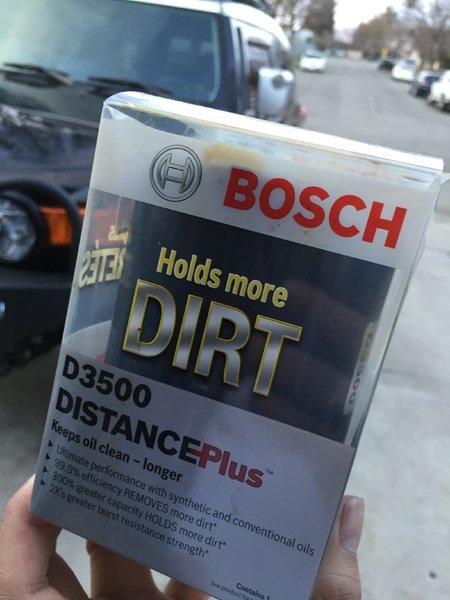

  5. Apr 30, 2016 at 10:06 AM
    #25
    Asianguywithatruk
    Asianguywithatruk Well-Known Member
    Jan 18, 2013
    #95517
    603
    CenCal
    05 taco DCSB
    King RR coilovers Ironman leaf springs 17" scs sr8 jet black 285 75 17 Yokohama geolandar Demello front bumper Brute force rear bumper
    This I what I been using. Can't really tell from the photo but it's about twice as big as the taller oem filter.

    I've never used one, but they look like a quality filter and Bosch usually makes good products.

    Bosch places their name on many products. Haven't looked into that filter.

    Could be okay for 15k miles but I would have more faith in my Baldwin or even a Donaldson. I will cross that number in Donaldson's Web page and see what comes out of it. If the micron rating is lower than 40 absolute might be worth it.
