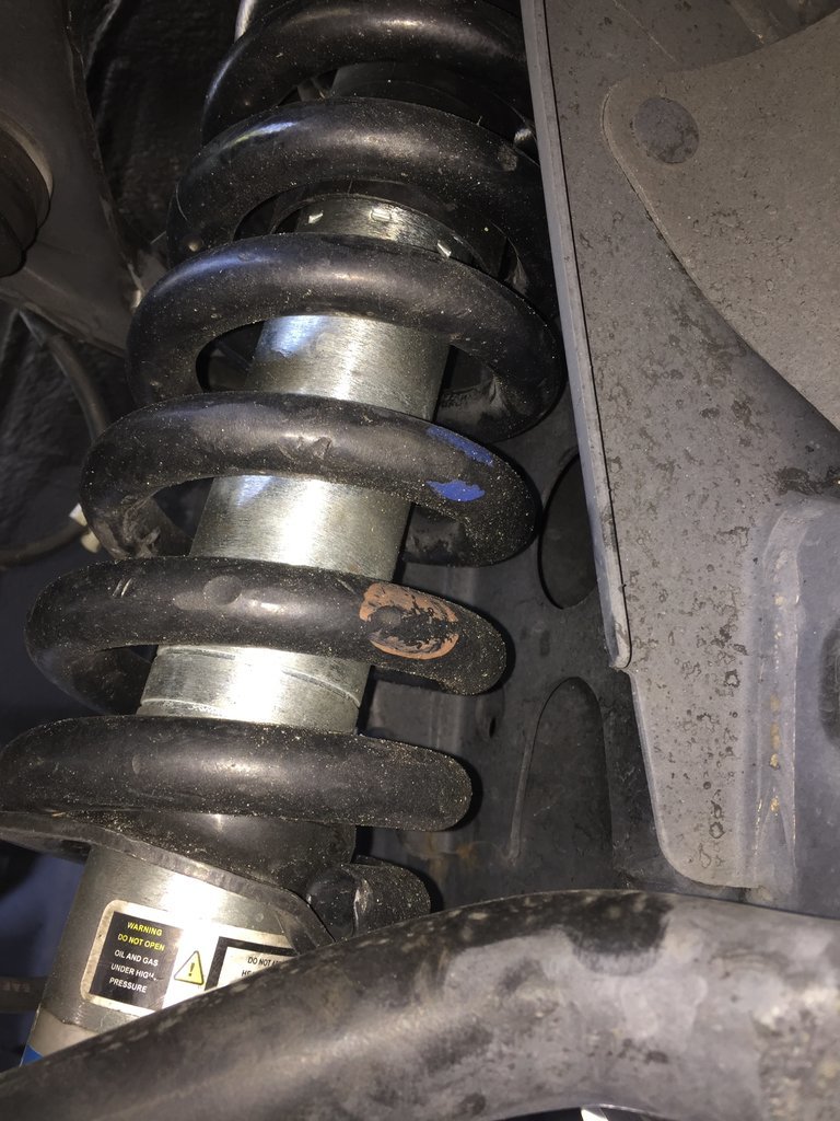

    The coils are color coded, but I can't find any info on what colors are supposed to be on what side. I found a few threads about it but the colors on mine don't match up with the ones people were talking about on here.

    What colors do you have?
    From what I've seen the coil with the double colors is driver side(mine were yellow-yellow).

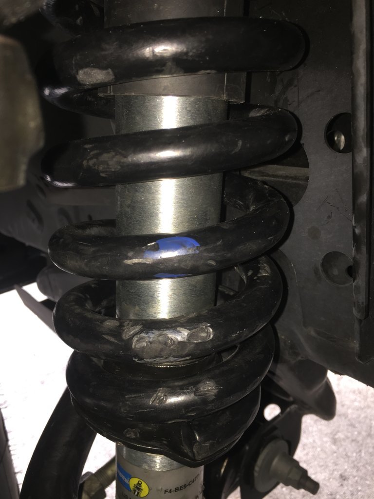

    Paint looks like it was rubbed off by the spring compressor on the driver side but I have two different colors on the passenger side so maybe that's a good sign

    The color coding of the coils is a bit of an unsolved mystery. This is the best info I have seen.
    courtesy of @Evenflow:
    The coil with two coils marked the same color is the drivers side in my experience twice and I have the read the same on TW. My Sport and my wife's 4runner both had an additional coil on the drivers side, IE: 5 coils on passenger and 6 on drivers. When you have two identical appearance coils one is still a higher rate that the other. If you have them on a 5100 from the stock to 1st notch the coils will actually spin on the lighter passenger coil but the stiffer drivers coil will not spin. Grab the CO by the coil and the rod end and see if you can spin the coil the one that you can't spin or twist has more pre load = driver side...hope that helps
    https://www.tacomaworld.com/threads/which-coil-goes-on-driver-side.335271/#post-8870313

    Mine were grey/grey on the drivers side
    and green-blue/grey on the passenger
    time has removed all but one of the paint markings now
    @Justinlhc:
    "From what I've seen the coil with the double colors is driver side(mine were yellow-yellow)."
