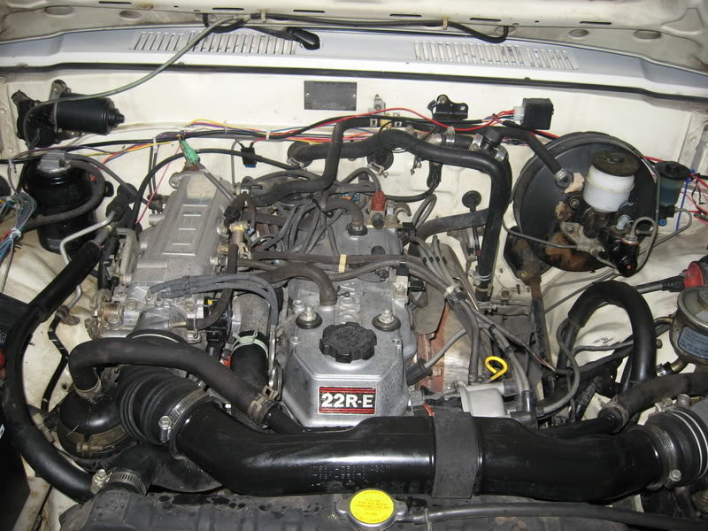

    Hi first off i just did a motor swap about a month ago on my 88 toyota 4x4 and the motor came from a 86 4runner and it strats and runs but its misses well like i can take off in 1st gear and it wont miss then i can shift to 2nd and it will do fine till i push the gas so far down to try to pick up speed then it starts missing and sputtering till i shift to 3rd then there on out same issue! I put new plugs on the truck and i got brand new plug wires and rotor but i cant use them cause the dam truck uses male ends on all the plug wires and coil pack as to my new rotor and wires are female! But odd thing is it didnt do it with the original motor so im thinking its something else.
    Also i found this pipe sucking air into the motor! what the heck is it? my other motor didnt have this
    and should it have a filter on it? i was thinking about hooking a hose to it and running it in the breather unless some one can tell me what it originaly hooks to.

    The first pick is the cause of your problem.
    Whats the second picture of?

    It's the auxillary air valve. There should be a hose from it to the air box (i think).

    2nd pic was just a top view of it
    there is a spot on the air box pipeing thats been blocked off dose it hook to the pipeing that gose from air box to throtle body or in the air box its self?

    See that ball looking thing on the bottom left? It the resonator. It should have a pipe(hose) for the auxillary air vavle into it, then you can see the other hose that runs along the main intake. It goes into the air box.

    My truck dosent have that ball looking thing i take it the 88s didnt have this and its a 86 motor i used.
    wonder if i can just run it into the air box or if it has to have that ball thing

    The 22re's have it and the 22r's don't.

    It's part of the EFI system. You swapped RE motors?
    EDIT: TOTAL brain fart........carb motors didn't have air boxes

    Im not sure i bought it the way it was it run good and i burnt the motor up so i swaped motors they both where fuel injected. My burnt up motor dosent have that auxillary air valve i can take a pic if u need it i still got the old motor.

    This is what it should look like. Well, what goes to that valve you were originally asking about.

    I found some difference from year to year. But I think you need to get this style air box.

    Heres my pipeing maybe i can plug into this hole or dose it have to go into the air box ?

    It goes directly to the air box.
