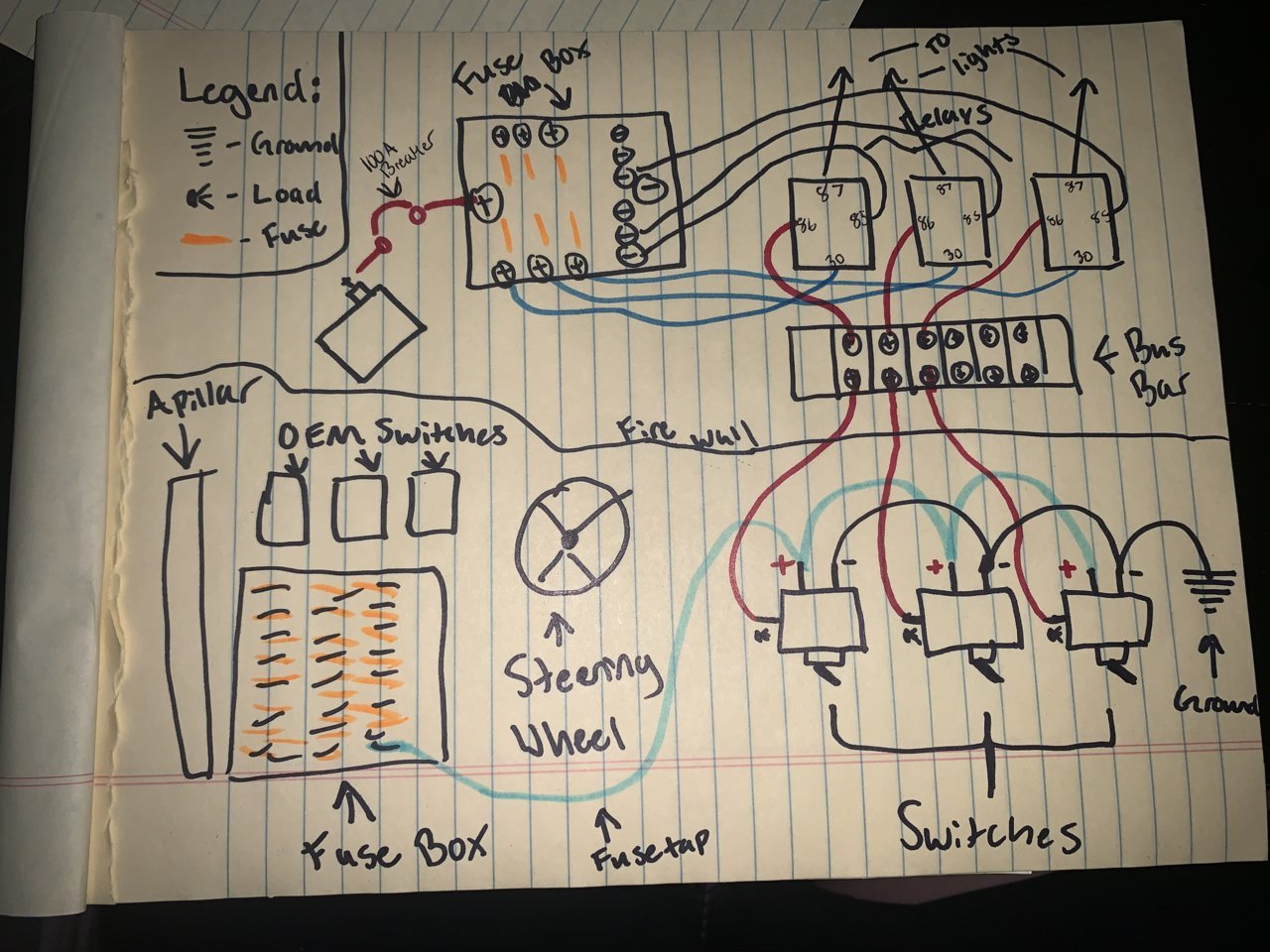

    Hey y’all, I have some time to spare do you Covid and I am finally working on my switch panel and relay / fuse box with my free time.
    I’m new to this whole wiring thing, but I thought I’d give it a shot.
    I drew up a very unprofessional and highly unorganized diagram of how I am planning on doing this wiring. Could someone with some knowledge/experience help guide me in the right direction?1CB65278-BB62-4F27-91C0-820E6A54212D.jpg

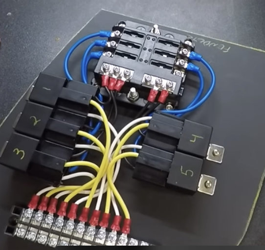

    Inspiration for fuse/relay box:

    Just remember to run a main negative off of your fuse box, but everything looks fine. I don't know if that's where you got your inspiration, but iggycorp used to make switch panels that pressed in place like the one you made up. If you haven't, give it a search. It looks like you should be able to fit way more than 3 switches and an outlet in there.

    And I think I could probably get 3 more in there, I’m just more concerned with engine bay space and all those extra relays would make me rethink my game plan because of the extra space.
    Oh and I totally forgot to draw in the main negative. It’s real late here lol

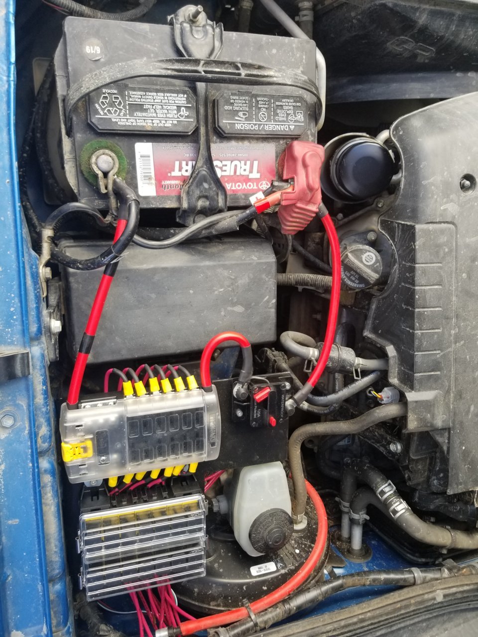

    He doesn't make them anymore, I just brought it up because it looked similar. If you want more relays, look into the hella micro relay holder. They hold 7 micro relays in a compact water tight package. It's small enough I was able to fit 2 of those, a 12 circuit blue sea fuse block, and a circuit breaker all on the same panel.

    Mine for example:
    If you were to use a 6 fuse block, one relay panel, and your circuit breaker you could keep it even more compact.

    Did you run your lights directly from the relay? Instead of using a buffer bus bar?

    Yeah, I wanted to use a bus bar, but I didn't really have any room left, so I just used quick connects off of each relay

    100 Amps is 1200 Watts (@Nominal 12Vdc). Depends on your total load and future goals for the sub panel. Your pic shows Three loads, but your pic has 5 relays. If there are no starting currents than it’s simply the sum of the loads. If it’s three sets of LEDs and they draw 1200 watts I’ll be able to see you coming for miles!

    Oh and for the breaker is it best to go beefy with a larger amp load or try to get closer to the smaller amp load I plan on running through them?

    Give yourself a little bit of leeway for your startup current, but the breaker should be slightly more than what your combined loads are. The fuses should catch the individual circuits, the breaker is for worst case scenario. For example I think my panel was rated for 100A so I went with a 120 Breaker.
