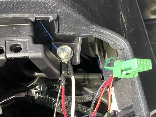

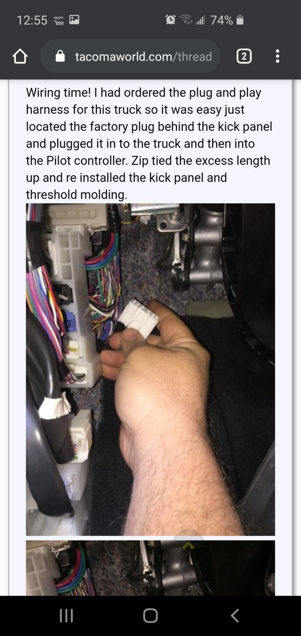

    20200325_124221.jpg 20200325_124221.jpg I'm gonna bump this again. I cant find my harness under the driver side kick panel....no obvious harness in view.
    Help?
    After some more reading thanks to @RedBeard1 for this install pic. I found it stuffed under the carpet and followed the lead off of the back of the harness holder

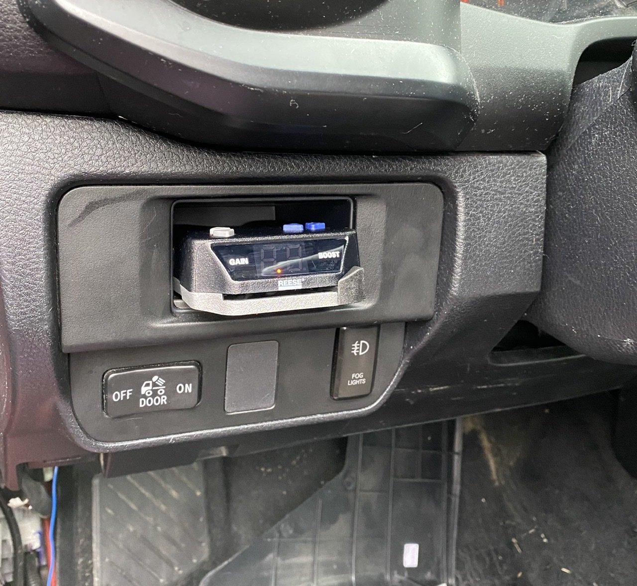

    I installed a Curt Brake-EVN proportional controller
    Reese 8508211 Control Proportional Brake-EVN https://www.amazon.com/dp/B01M59QRWK/ref=cm_sw_r_cp_api_i_N8sOEbQ2EDDFP
    using the Tekonsha 3031-P harness last weekend. I grounded the extra wire on the bolt under the dash where I also grounded my fog light switch.
    Only used once to tow home my new to me trailer but the brakes work on the trailer with it connected and it’s easy to use, adjust, and manipulate with its placement in the cubby so I’m happy so far.

    For 3rd gens there’s a company that makes a plate to cleanly put your controller in the little cubby left of the steering wheel. Sorry, don’t remember who, but Google knows.

    It can be done even cleaner. Check out Meso's solution:
