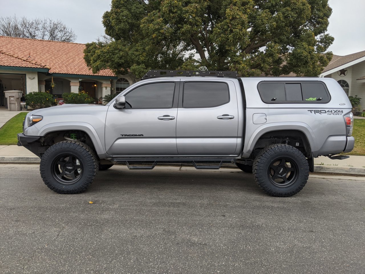

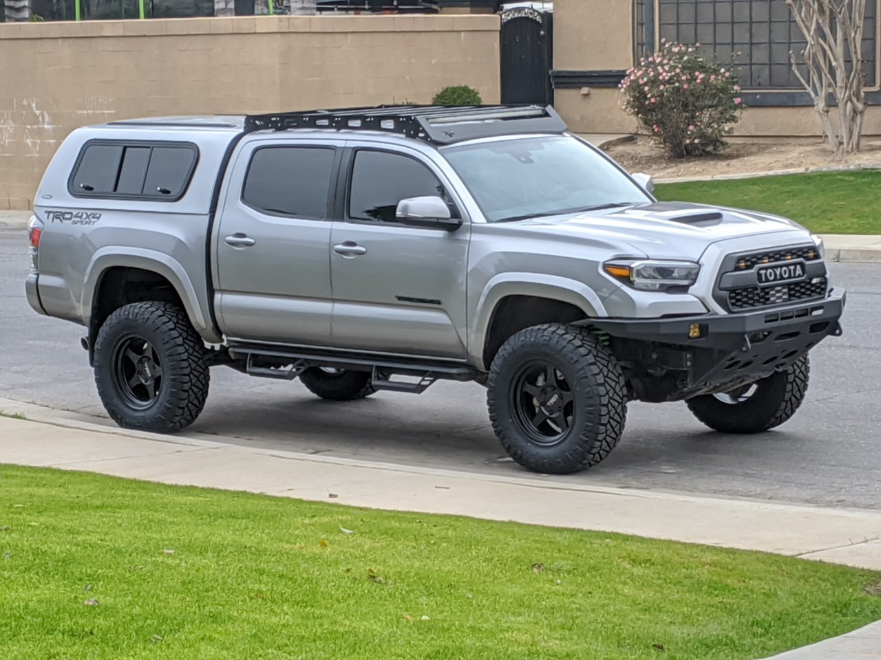

    Yeah your tires look a tad undersized :) Do you know how much height you gained over stock?
    Nice lift!

    4" in the back and 3" up front.
    Also: Tire shop got me in early today! :headbang::headbang::headbang::headbang::headbang:

    Looks good. What tire size did you go with? Any rubbing?

    Thanks! I'm stoked on how it turned out. :D
    285/70/17 ridge grapplers. None so far but I ain't tested anything. Going to take her wheeling tomorrow. I was kicking around the idea of 285/75/17 originally and had the cab mount chop / pinch weld smash done when I got my lift installed so I doubt I'll have any problems but we'll see.

    Please report back on the rubbing. I'm getting tires soon and I rather not do any fender trimming.

    No rubbing to speak of today. :thumbsup:
