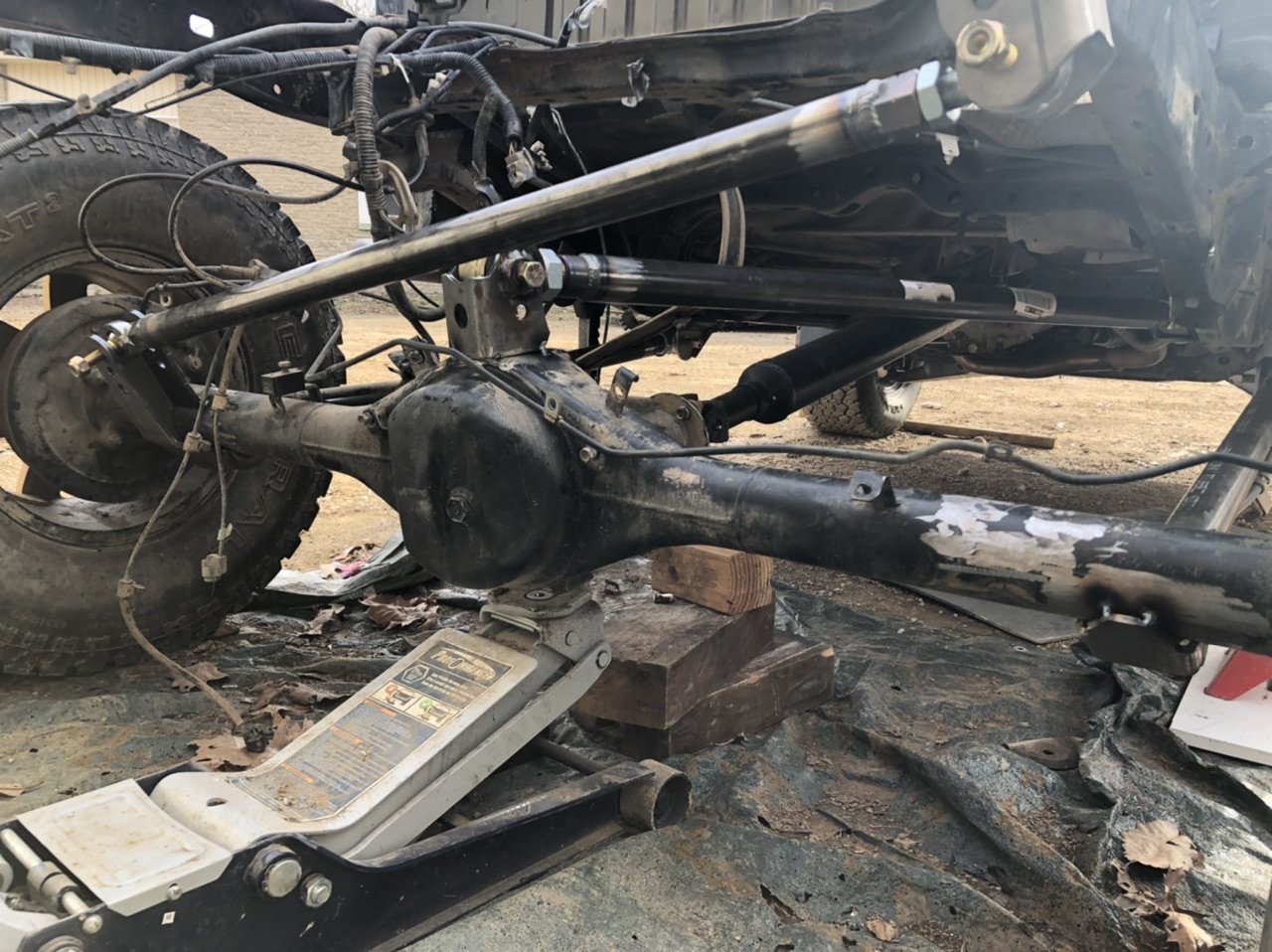

    Not to hijack the thread but I’m currently in the process of linking my rear. Is there a sway bar you would recommend? I’ve seen them priced from ~300 to over 1000 and not really sure what I’ll need yet. 51C48D88-3F8C-4A29-8D89-72B4F64F4BEE.jpg

    TK1 racing makes a really good kit(what I have) and I'm running the medium wieght desert bar. And my truck handles very well

    DIY Antirock kit works well. We put one on my buddies TJ in the rear when we linked it. Considered one if I link my rear.

    Looks like a ruff stuff link kit ?

    It’s RST’s kit with some ruff stuff mounts.
