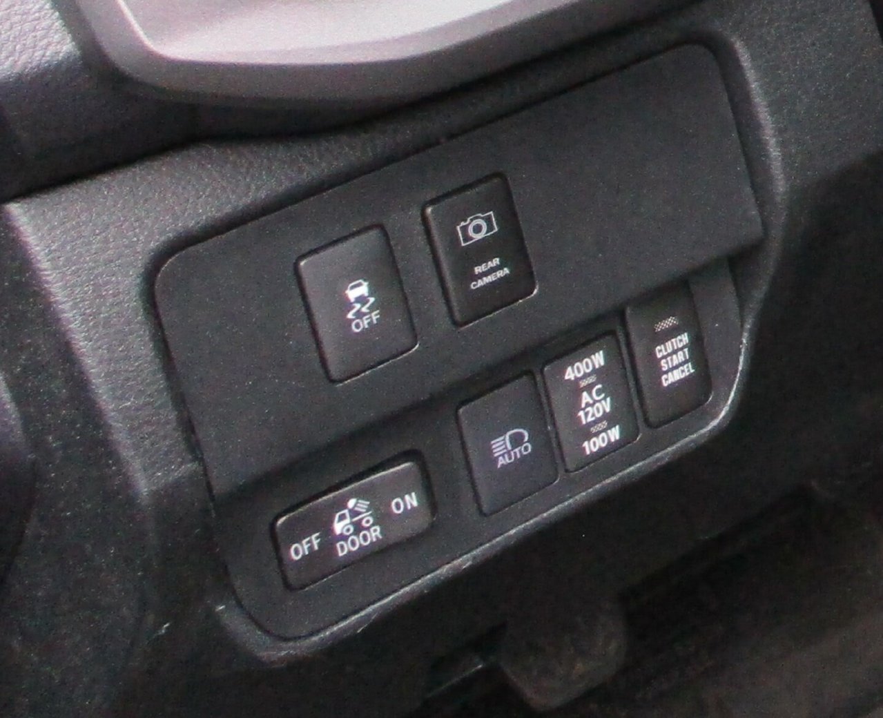

    I just want to be able to turn on the tail gate cam.

    Yes, AnytimeBackupCamera.com sells just the override harness. You have to call them and ask, but I think it's in the neighborhood of $40. You'll also need the dash switch (Air on Board has nice ones that match the LED color of the other switches). If you want the switch to be illuminated, get a jumper harness from Kyle Morgan (member here). All together, it should cost you about $85 (plus a little work) to be able to turn on the backup camera at will.

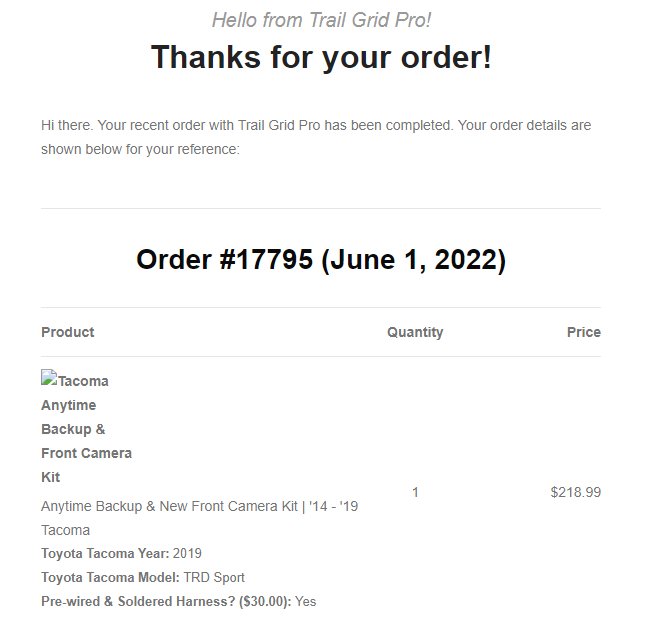

    I just bought the front camera kit yesterday. My truck came with an auto high-beam switch that I've never used before so I'm going to take it out and stuff it behind the dash and replace the empty hole with the dual-switch for the front/rear camera. I don't feel like spending 6 hours ripping my dash out again to install it below the infotainment system
