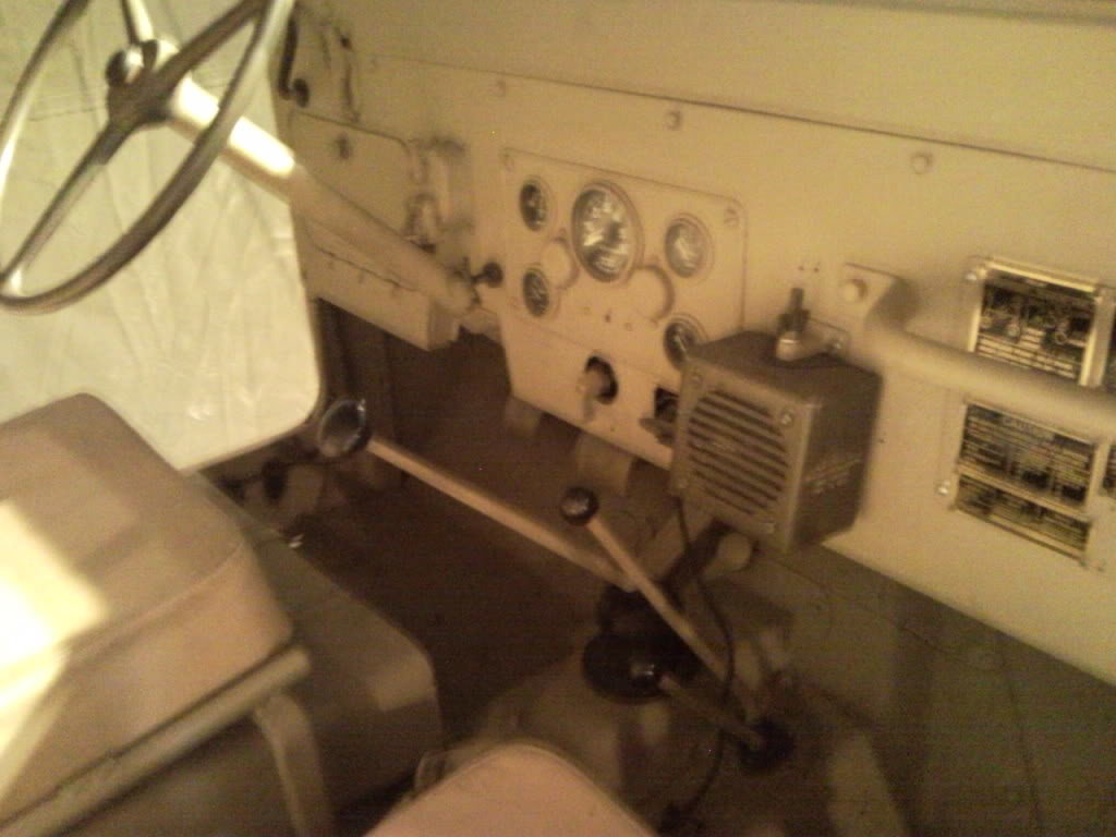

    ok. so i went to a military museum and saw this. can someone tell me why this jeep has 3 shifters in it? i know one is for changing gears, and one for the 4X4 but whats the small 3rd one? i included the info sheet of the vehicle.

    Could it possibly be for the PTO? :confused:

    Looks like this is a CJ3B and (I just learned) apparently they came with an Optional Power Take Off transfer case...which would allow you to run powered equipment off them (farm stuff, mower decks, snowblowers, etc)
    So one Trans shifter, one 4x4 shifter, and one PTO shifter.

    I just looked it up and it appears they had the Dana 18 Transfer case in them which looks like they had a dual shifter for high and low up until about 68 and then they swapped out to a single shifter :confused:

    ah HA!!! YES! Looking at the pic closeer, the stick goes into the same hole, indicative of a separate Hi/low and 4/2 shifting. The PTO shifter on my M-37 is a bit further away from the trans and tranny shifters.

    so one is 4hi and one is 4lo?

    Next time take a picture of the shift pattern above the glove box.

    One is High/low and the other is 4wd/2wd

    Yep, I had a 1958--One stick=4x4H. The other=4x4L:)
