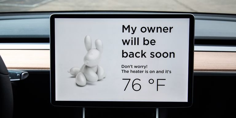

    I'm not sure of the legality of it but Teslas have a mode exactly for this. It even says across the screen in big letters the AC/heat is on and at what temp.
