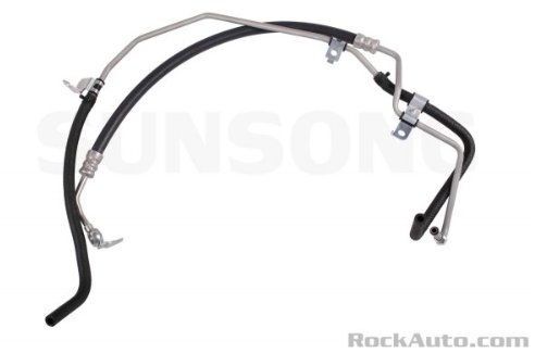

    That seems maybe a little high, but not too far off the mark. I see the hoses at RockAuto for under $90:
    For a new rack, pump and hoses it looks to be about $550 in parts. Labor typically 2x parts cost, so $1700 seems about right if they are changing out everything. Oddly, remans seem to be as much or more than new.

    Yeah.
    Personally, I'd crawl under there and verify. The descriptions on the RockAuto hose parts seem to indicate that there are 2 options, one that covers the Base Model and Pre Runner, and another for the X Runner. Nothing about 4x4, so I just assumed that was covered by the non-X Runner parts. But, the rack parts sometimes get into more detail and nothing specifies 4x4. Maybe the 4x4 part is different?

    4x4 is typically covered under "base model" in most aftermarket catalogs. There's only one rack P/N identified in Toyota's OEM parts catalog for both 4x4 and PreRunner, and it shows threaded inlet for pressure- and return hoses: https://parts.toyota.com/p/Toyota_2...-For-Rack-and-Pinion/63031061/4425004030.html
    Crawl under the truck and identify exactly which tube is leaking. There are two tubes connecting the control valve to the rack cylinder that are not sold individually:
    It should be possible for most shops to make those for you, same as making brake lines. Consider however that the rack is likely to leak by your truck's age, and the hours of labor required to finagle the rack out of the truck to replace the tubes, it might be good to replace the rack anyway. If you go reman, stick with BBB and avoid other brands like Cardone.

    The hard lines connecting the control valve to the rack cylinder? Yeah probably. It's pretty tight in there.
    Bending and flaring hard lines for brakes and power steering is relatively easy, but is best done with a $500 flaring tool. Most good shops can do it routinely.
