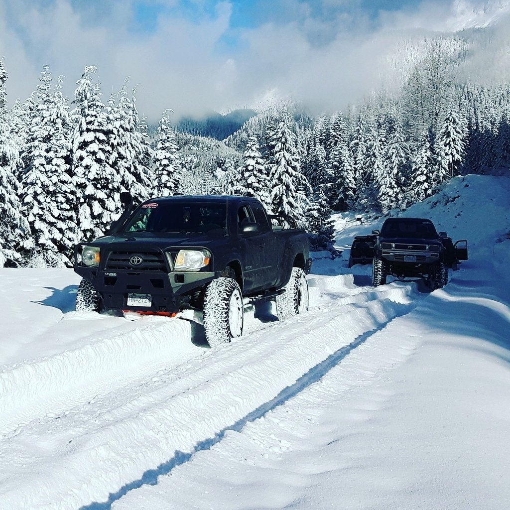

    I have a 1" BL and my winch bumper was custom ordered to accommodate it it's a one off

    That's a good lookin' bumper. I'm checking out Cruisin Off Road now.
