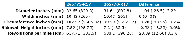

    According to the tire size calculator, they don't have the same circumference. That's where the problems could come from.

    According to the tire size calculator, there's less than 1/16" difference in diameter. That's not even enough to matter. However, different manufacturers make tires with different dimensions so, there could very well be a much greater difference. I'm sure you don't have the same looking wheels front to back, so why?

    There's a full inch(ish) difference in diameter.

    Nope. You punched in 17 for both sizes.

    Less than an in. difference. But with 4x4 engaged, both tires should move the same distance pr. rev. For each rev. one tire must slip, slide, or scoot, that extra distance. If I'm figuring right, At roughly 620 revs. pr. mi., a 1/2" difference in circumference, the tire has slid or scooted 310 in. or appx. 26', gosh that seems like a lot !!! ???

    Nope, you're figuring it wrong. 1/8" difference in circumference. I'll bet that the tire squish difference between front and rear tires, due to weight difference results in more difference than that, even with same size tires.

    Thanks, I stand corrected. That being said, using your 1/8", the tire would only need to be scooted appx. 6' 6" pr mi. more than it would have been scooted if front & rear were the same circumference. shoot, I hope I got it right this time.
