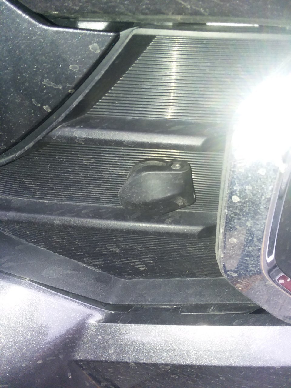

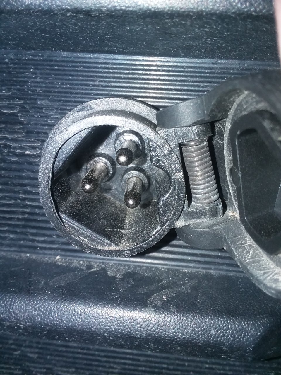

    I purchased a 2016 Toyota Tacoma from a dealer in Idaho. It was made in Canada and has some wierd features. One of them is a port just under the driver's side headlight that the dealer thought might be for a built in block heater. I have tried several cords from US parts dealers but non of them fit the port. It has three prongs (see attached) and an odd almost pentagonal shape. All the cords I have tried from US dealers have a round shape. I have contacted a few
    Canadian parts dealers but have had no feedback as of yet. I thought maybe someone here would have an idea as to where I could get a cord to fit this plug.20200204_122705.jpg 20200204_122638.jpg

    Here you go.
    https://www.tacomaworld.com/threads...llation-toyota-canada-p-n-pu140-00911.346032/

    I’m in Manitoba Canada, I have the same port for my block heater (seperate cord/special) its cool

    Ontario Taco here, I have the same setup from the dealer, but my connection looks different. It’s a great setup, though. Comes unplugged easy if you forget about it and drive off, too. Lol. The little springy door cover on it isn’t strong enough to close tightly, so it ices up sometimes... gotta look into that. First time I’ve seen another setup like this on this forum.

    Pick a Canadian city. Find a dealer website and get a cord. They are available in a couple of lengths.
